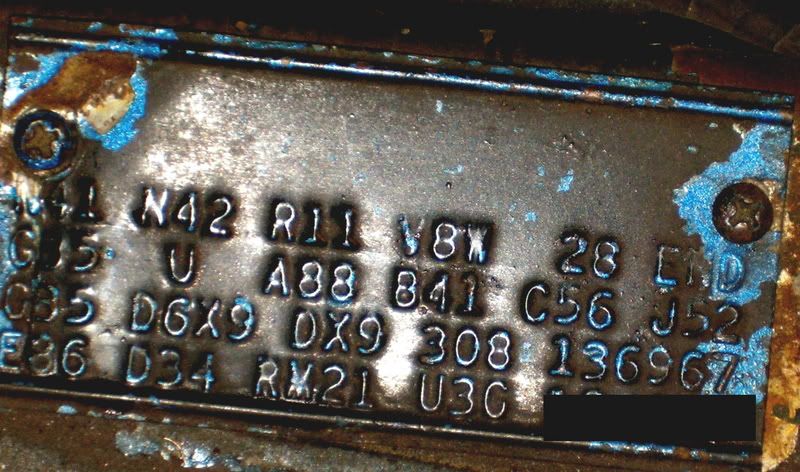

i send my drum with my buddy to have them media blasted . he called me last night & and said there was indeed red under alot of coats black paint . so i guess they still did the red face in 73 . ? . :yes:
What wheels did your car originally come with?
i have no clue and i dont see anything on the fender tag that tells me .
Won't be on the fender tag, but it will be on your build sheet
