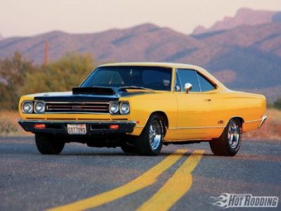

I really like this look, where would this color fall on the scale between black and white?
BTW, your '69 is killer, mine just doesn't have the body for black.
Thanks man! It's the last black car i'll ever do! LOL. Anyways...thank you!
That's a pretty mean looking bird! I'd think that yellow would mask some unwanted eye catcher's pretty nice. Sharp looking color on top of it.

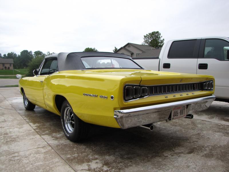

Here's a shot of my Coronet. Hate to say it, but the color is 1974 Corvette yellow (not my idea). Anyways, this is a single stage paint, wet sanded/buffed out pretty hard. It might possibly give you an idea how the glare reflects the body surface in the color yellow.
Wow, thats a mirror finish! Nice Coronet, you damn sure won't lose her in a parking lot. :hello2:
