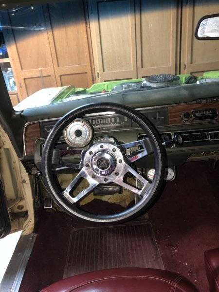

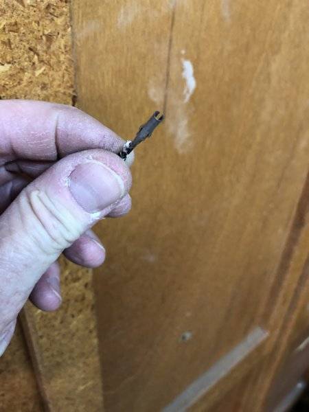

Hi I am one bullet type connector short in hooking my Sun Super TachII. I don’t know the name of this contact so finding one is that much harder. Its meant to compress over a single male pin roughly 1/10” or 2.5mm. On the other side is a wire crimp/solder connection.
The spring action is in the female side unlike a banana connector. This is an important attribute.

Molex. Same used on your ign switch plug

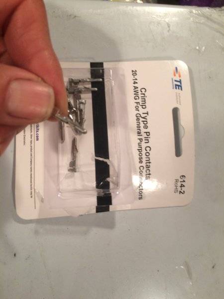

Try an electronics store like So-Cal's ORVAC or https://www.elliottelectronicsupply.com/ located in Tucson. You are better off walking in and selecting a match to yours but if you can get a length and diameter of that female terminal, that's really all you need. I know there are a few different sizes in this style of connector such as the 20-14 AWG depending on current load but the differences from size to size are obvious. Here is a picture of a pack of the male side of the terminal you are holding.

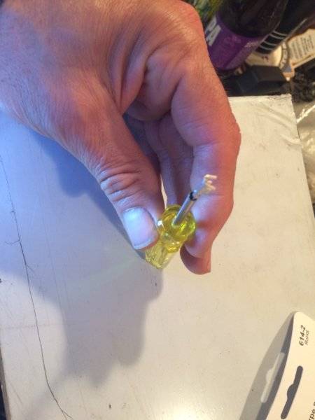

You might as well get some tools so you can make the work much easier. You'll need a.....terminal extractor? This hollow tool slides over the connector to the base and pushes the locking tang inward so the terminal will pass out the back side of the plastic terminal block.

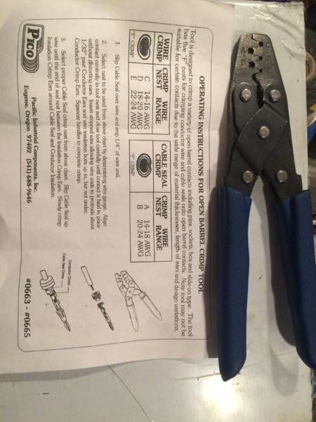

You will want a good set of wire crimpers. These can be had from any electronic store. Pico is a decent brand but there are others.

Thanks fovirgil I got her done!
