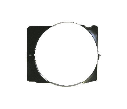

My game plan now will be clean and flush system and add shroud with stock fan that should do what I want. Bought the shroud from Mancini racing.
Is that fan shroud the one where you have to use zip ties through the cooling fins to mount it? Send some pics after you get it in.....thanks!
The shroud is the one sold by Mancini its for my car and has an attachment kit also that bolts it on no zip ties its metal not plastic. it fits 62-68 22inch radiator.

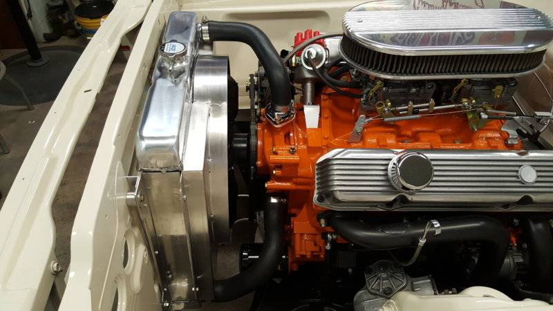

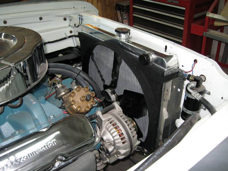

I used an 18" rigid race fan with steel blades on mine (Summit Racing # DER-17318). It's rated to 8000 rpm and with my home made shroud works fine and keeps my mild build 440 at 180 degrees even in the Texas summer heat.
Same one I used. Derale brand. Mine is the 17" yours the 18". Great quality, works great and you can't beat the price!

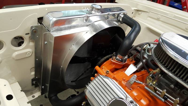

Very nice work on the shroud ! Buy a kit or build from scratch? I need one for my car . Been thinking of a kit from speedway or summit and modifying as needed .
I drew it up with the measurements and had a local fabrication shop make it. I didn't have access to the machinery and a heliarc like I did when I was working.

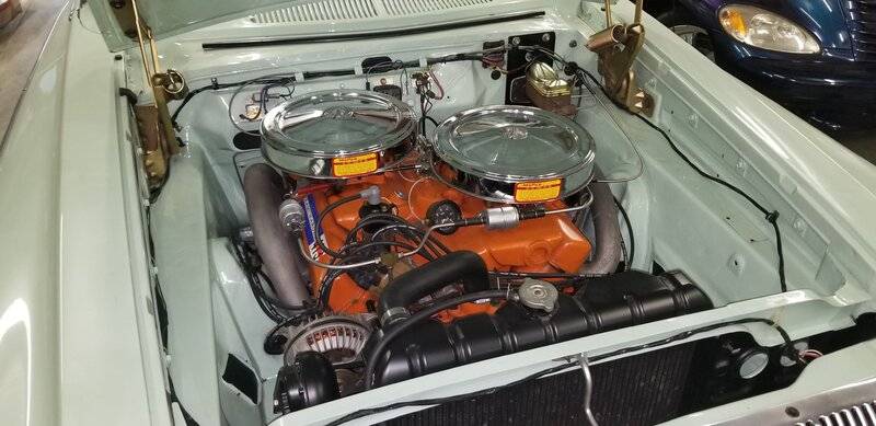

Original Mopar radiator & shroud, courtesy Bob and Crew, at Glen-ray.

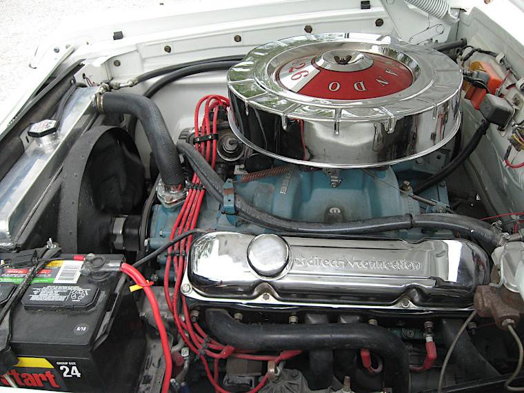

Fan & clutch from Mancini. Fits great, waiting to test the temps...
