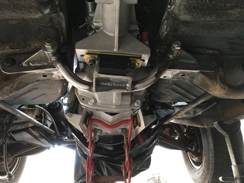

I like the tube k-members with coil overs and such because of the steering and brake upgrades, but they are out of my price range currently.

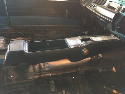

I have a 2008 6.1Hemi I would like to put into a '69 Coronet with the Nag1 transmission.

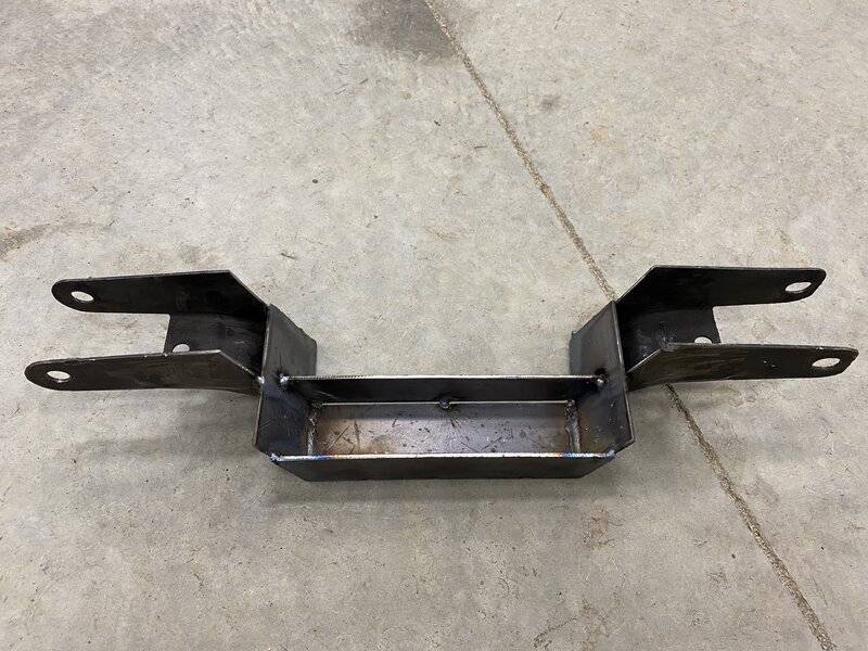

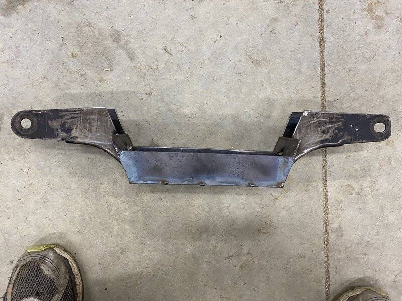

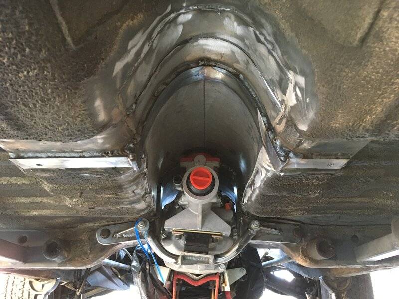

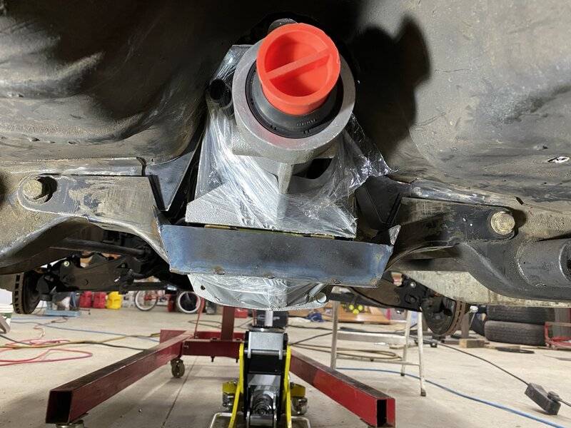

I cut the ends off of a stock crossmember and made the rest from 1/8” plate.

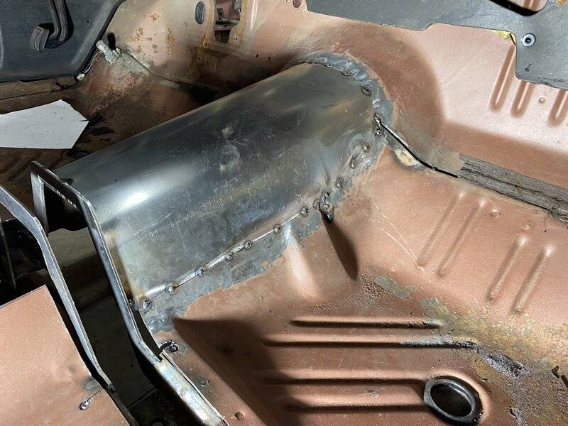

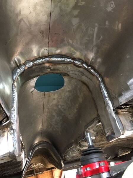

It's a 67 satellite. I did remove the center of the crossmember and rebuild it higher up. I'll post a couple of pics. It's not done yet but the majority of it is finished.
