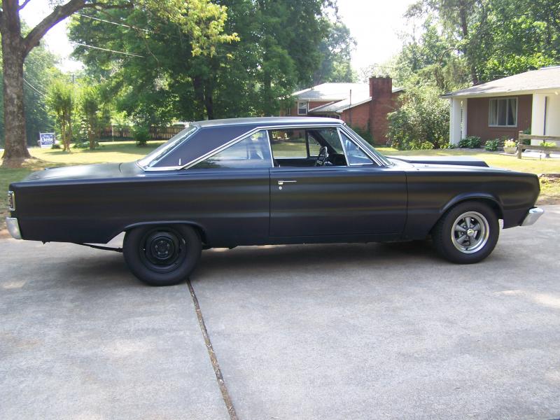

With your cars street / strip engine combo what do you shift your car at and what have you learned about your car & its setup likes and dislikes.. I have yet to run mine but will this next friday night & will post the results...
