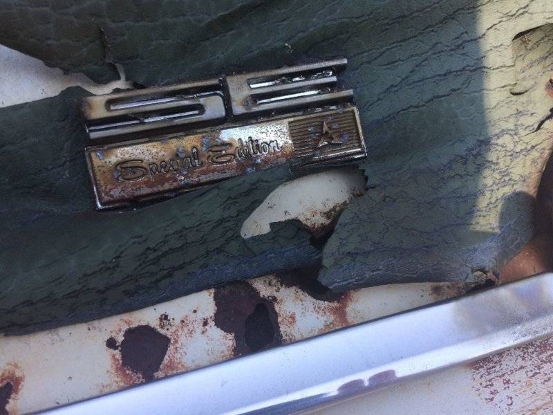

Does he have these on the roof sides? ''A47'' code ''Special Edition''.

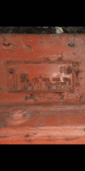

Looks like a Dec. 5,1969 build, 318ci w/AC and heater, go mango w/tan something? Thats the best I can make out. Only 137 318ci's built w/ Go Mango paint.
