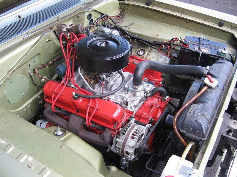

What are you guys using for filters in these air cleaners? The ones that were used on the 383 and 413 four barrel cars, and open around the bottom. These take a filter that is about 9-5/8" around and 3-1/2" high. I am not finding them listed in current catalogs. (My air cleaner is from a 1964 Chrysler 300 with a 413.)

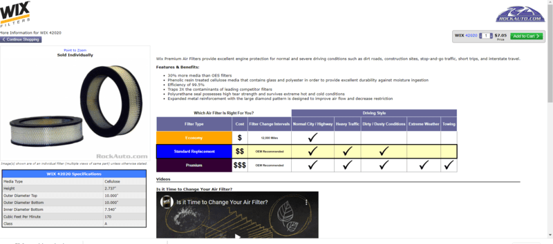

I have an unsilenced from my Charger it's the same filter as my 1993 Dakota. WIX 42020

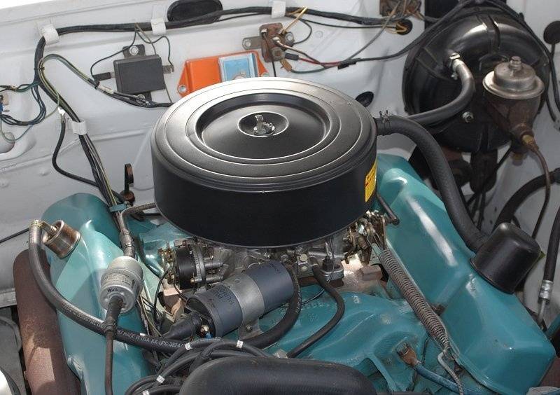

Mine is original from my 66

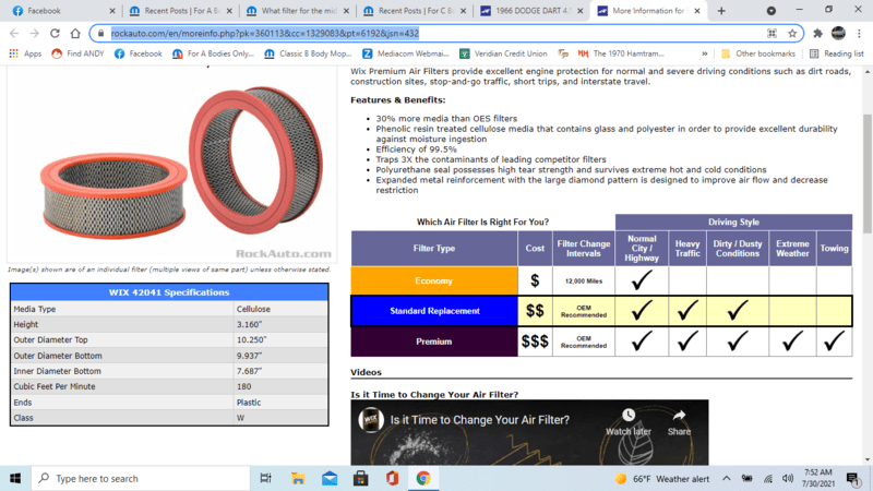

Don, Thanks for your help. It looks like my air cleaner, which I bought off a wrecked 64 Chrysler in a junkyard, must have the wrong filter element. I researched further and found the air cleaners shown on this site: https://www.nicksgarage.com/aircleaner.htm

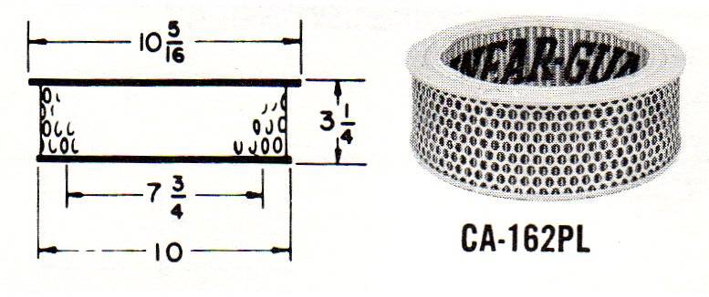

It has filter part numbers listed, and calls for Wix# 42041. The drawing shows these original dimensions.
