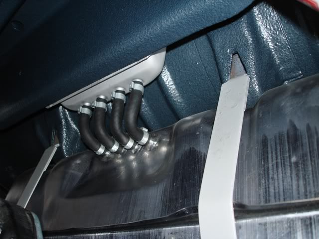

Here is what the separator looks like in case yours may be missing.
Thanks idrivemopar, you have confirmed what I thought. Thanks for the picture, very helpful.

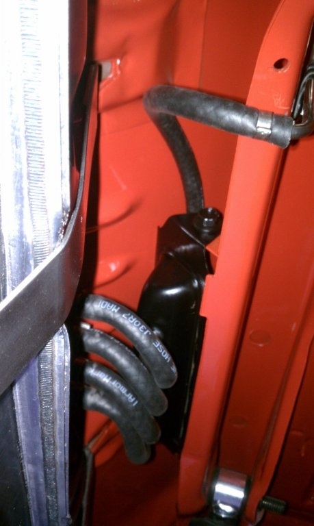

Thanks again guys. One more question, how long are the lines from the vapor separator to the tank? Everything is off the car right now and I want to make up some lines before putting them back.
Mine is setup with 6 inch lengths, snugged up against the tank and the vapor separator. I used the stock type pinch clamps to secure them.
mid year '72 change to the later style vapor separator, indeed pretty much lines up directly with the tank nipples, short hose run.
