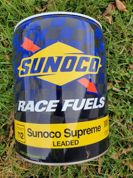

vp or Sunoco racing fuel, im Montreal and its easy to get , last time we bought a 205 litre barrel
was about 6-7 dollars a litre.quite pricey , smells great . love racing fuel. 112 leaded as posted above
I am able to get the 112 in at the pump, in 5 gallon cans or in 55 gallon drums from Sparks Oil Co. where I live.
A 112 5 gallon can is $69.00 and last I checked, a 55 gallon drum is $546.99.
The 100LL has more lead than you'll ever need for seat lubrication Jerry. More than premium leaded ever came with..
Interesting. We get 5-gallon party balls of VP110 for about $75 here, close the same neighborhood in pricing...which is surprising because I'm sure our pump gas is considerably more.
