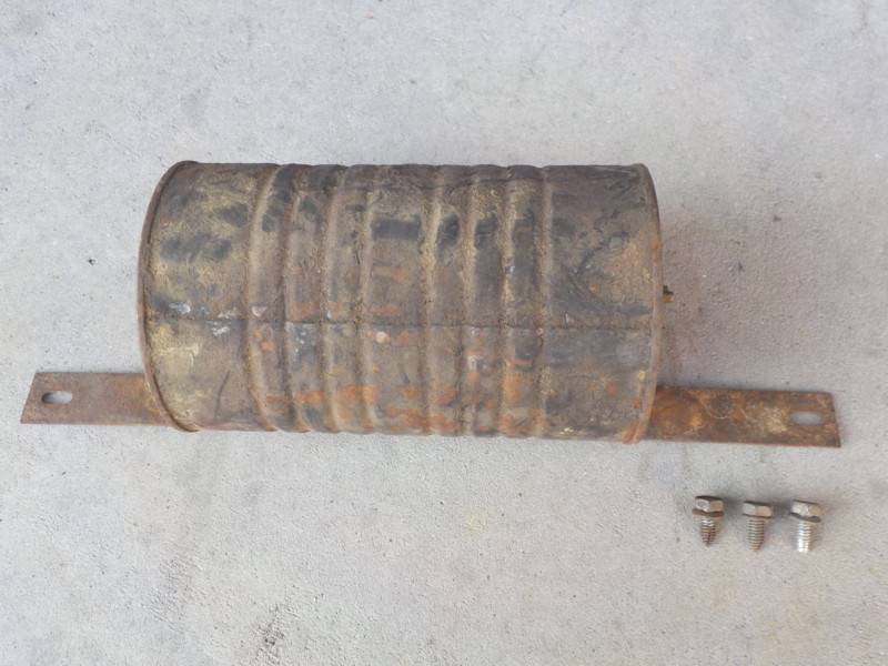

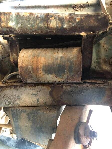

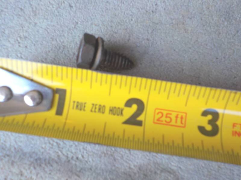

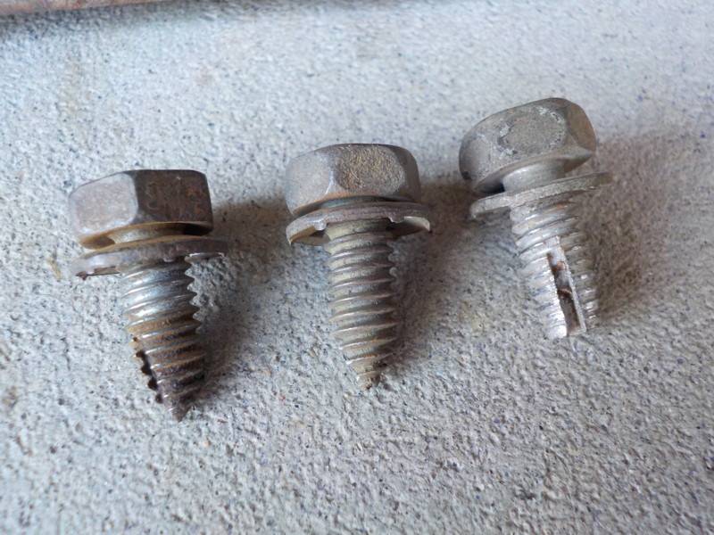

Hi guys; Can anyone tell me what the hardware looks like for mounting the headlight vacuum canister to the frame rail on a 1969 Charger? Is it a self tapping bolt or standard? Standard or tooth washer? I enclosed a picture of one installed. It definitely looks like a hex bolt rather than a screw. I found some bolts in my hardware bins that may or may not be correct. Can anyone clear this up for me? Thanks,Dave

Looks something like so.
3/8" hex head.
Washer is molded to the head as shown.
3/4" length sounds about right.
I bought a box of 25 of said bolt on ebay a while back ...just no markings on the head
Do you know what the thread diameter is on those? The ones I pictured are tight and I didn't want to run them in until I was sure they were the right ones. Do you have a link to those bolts on Ebay?
1/4"
If you Pm me an address.
Ill send you some
