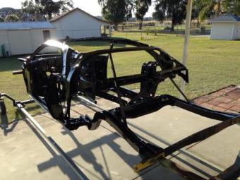

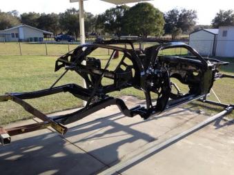

International Paint Strippers. Chemical strip to bare metal[everywhere], flush/rinse, e-coat dunk, bake. NO bare metal[anywhere].
