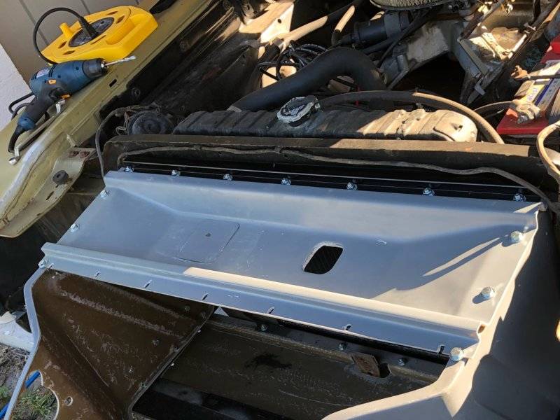

help, What holds the hood pop up spring in place on a Superbird? I am building a tribute and I have the spring, and I want it to be close to the stock configuration.

Mine is a tribute and it’s a fiberglass piece, but your close up picks will help me make it work...If you look my enclosed picture, you’ll see it’s a very different dealio.....yet, with your guidance, I see what I need to do.

It's actually just installed "red neck" style with 3 small metal straps and screws. At least it is on mine. I understand the Daytona didn't get a lift spring at all, and not truly sure the Birds did either. Only picture I could find on my computer... I'll try to remember to take a better picture for you tomorrow.

DadsBee is Awesome! That’s kind of what I was thinking to do... I really appreciate the guidance!!!!

It is the same on a 70 RR/Satellite. Ask me how I know? I snapped off the small eyelet on my 70 RR. Fixed it redneck style !!!! Actually used a black nylon cable tie cut close. Was totally unnoticeable.
