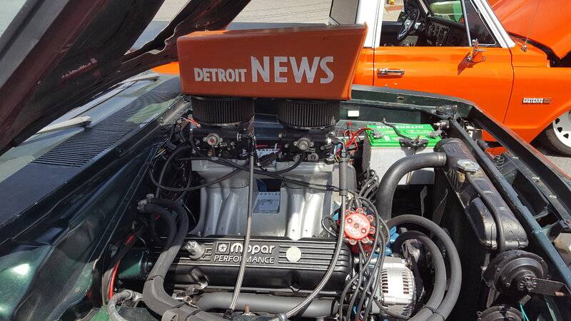

So im looking to throw dual efi carbs on my 73 charger, I am going with Holley sniper dual efi carbs for my 440 tunnel ram with a 727 auto behind it, I know I have to get a fuel pump and gas tank, but apart from that what else, fuel regulators etc?

Pretty sure the Holley Sniper EFI is internally regulated. If you get one of the master install kits it will come with just about everything you need to install. However the filters and pump will be external from the tank. Unless you buy one of the Sniper fuel senders/pumps that fit directly into the OE tank. They make it so you do not have to use a return line. I was looking seems they don't have the in tank sender for your car yet.
Everything you dont have related to EFI. So If you have nothing you need everything
Sniper EFI has internal regulator, so it will need a return line.
I went for an in-tank fuel pump with integrated pressure regulator at 60 psi, so only needed to run a supply line to the engine and blank off the return outlet on my sniper stealth.
Jus see first what is available for your car model on fuel pumps, preferably a kit with integrated pressure regulator.
Once you got that planned, the rest is easy.
Run the correct size fuel line, specially for 2 units.
Don't forget the O2 sensor to the exhaust. You should be getting the hand held device that will show all of the pressure settings, temps and flows. If buying the whole kit, instructions are pretty clear on what you will need. I ended up with the Fitech Street series EFI and love it. Good luck.
I used a Fitech which, except for the tunability, is about the same as Holley Sniper. Ran an external regulator back by the fuel tank w the throttle body regulator blocked off n no return, had issues w surging fuel pressure due to the distance. Was told by Aeromotive to either have regulator near throttle body, which would require a long return line or use the throttle body built in one which also requires the long return line. I'm using AN adapters on factory 3/8 line. Then ptfe 3/8 braided w adapters from factory line to throttle body. Same for return. I was able to run 2 factory 3/8 fuel line side by side.
