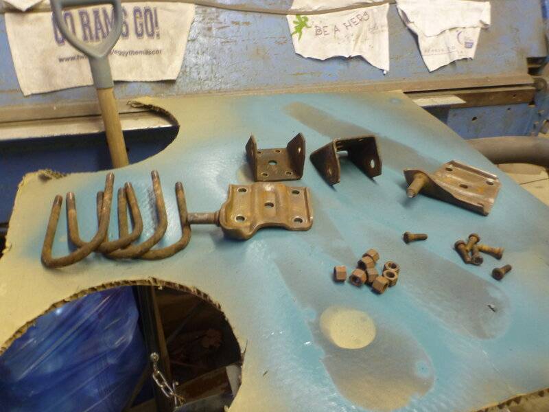

I have the OE's from my Bee and my Dart ready to go into the blasting cabinet. They are both exactly the same yet the 340 Dart has 6 leaf springs and my Bee only had 5. I'll try to remember to drop one over the axle tube tomorrow on my SuperBird to see if it's are the same or longer and get you a measurement.

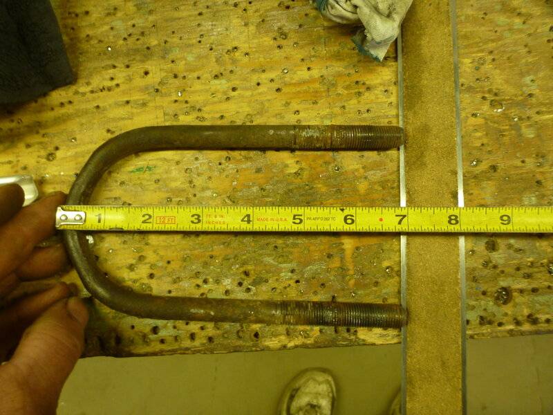

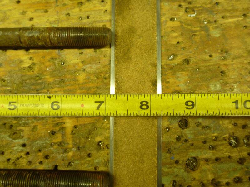

That said, my Bee (5 leafs) and Dart (6 leafs both sides) are both 7 1/8" from top of saddle to thread end. '70 Plymouth Superbird, 440, Hemi suspension option coded... are about 3/8" longer.. so 7 1/2". Lots of extra thread hanging out but if you want them correct that is what they are. Leaves lots of thread if you want to add some quick tie down strap plates for trailering if that's in your future.

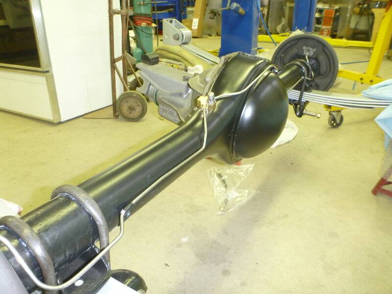

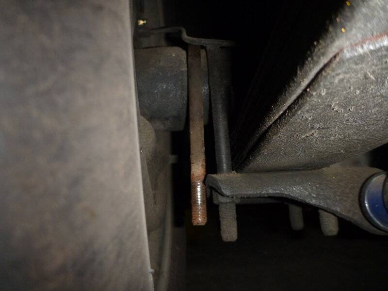

Well as you can see in the last picture either U bolt length will work just fine, all depends if you want it "correct" or simply functional. Not sure why Chrysler used all that extra thread on the 6 leaf B bodies. My Dart is OE factory with 6 leafs and it has the 7 1/8" U bolts. Bird the longer ones.
From our research in providing the leaf spring rebuild kits, Chrysler used two different lengths. That being a 6 & 5/8 inch and a 7 & 1/8 inch variety. The factory part numbers are 1489 746 and 1489 747.
As Wayne pictures shows and his information shows, either will work. We use the longer U bolts in the kits for the cars equipped with the Dana / Hemi suspension option.
If correctness is a concern for you, the picture in post number 4 from Wayne shows the correct "flatter" area on the outer most radius and they also use the embossed "X" pattern to better grip the axle tubes. Another area of detail is the "taller" 1/2 x 20 nuts as shown third picture in post number 12.
^^^ YEP, against my better judgement I measured them from the top of the U which matched the OP's 7 1/8" or 7 1/2" choices from some unnamed vendor. Normally a bolt length would be measured from under the "head" and that would match your numbers at 6 5/8 and 7 1/8 Richard.
