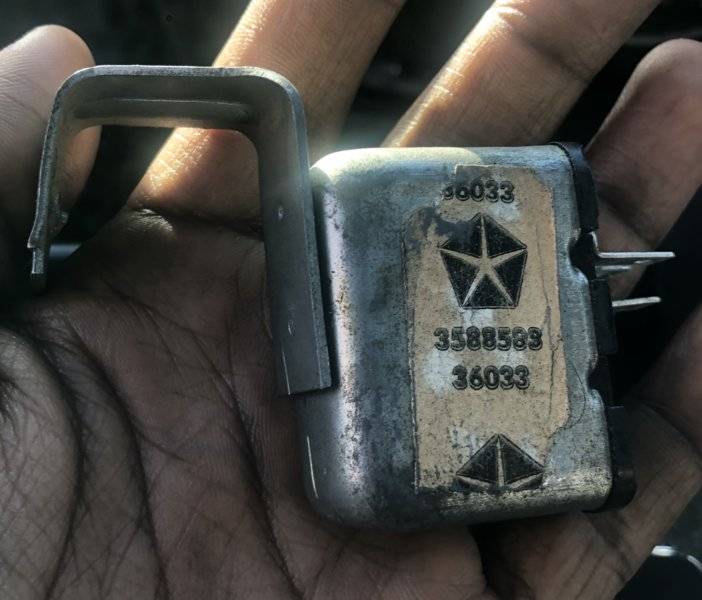

Can someone tell me the function of this? Horn relay maybe?
Seat belt? Kinda weird bracket for horn relay.
seatbelt relay, attached under the dash, usually next to the ashtray, you should have a 3 prong connector on your wire harness. The bracket with screw hole is to attach it to the channel on the underside of the dash frame.
I came up with the same thing as I drive, 74 and up I believe
ODZKing is correct on the year, as 73 and older were square not rectangle shape.
The warning buzzers, headlight and seatbelt are two prong, seat belt relay is the only 3 prong on the harness. The horn relay/key in buzzer is 3 prong with no buzzer, and 4 prong with buzzer, but it plugs into the bulkhead and does not have a bracket on it.
