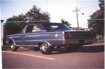

I'm getting ready to repaint my '67 GTX to what I call "Bright Blue Metallic".
My original '67 was a beautiful medium blue with some fine metallic particles in it. (below) (It was NOT the larger metal "FLAKE", of the day)
I've been looking at OEM paint chips and the closest I can find is the 881 "Medium Blue Poly". I've not been able to locate any description of "metallic".
SO...what am I looking for? What is todays equivalent? Should I look for lacquer, enamel, base coat/clear coat?? The current car, was originally a medium blue but has been repainted with a dark midnight blue metallic. I plan to sand off all the old and realy old paint and re-do with the 881.

Bright Blue Metallic (88-1) is a shade darker than Medium Blue Metallic CC-1. (Despite the fact that logic would make one think the opposite when looking at the names.) I have an original paint chip from PPG that I am looking at. 88-1 Is used in single tone paint jobs and CC-1 can be used in two-tone paint jobs (schemes). Attached is a pic of my original '67 GTX taken in 1969. (I have not yet painted my current '67 but have purchased the equivalent of 88-1 so as to match my original car.
