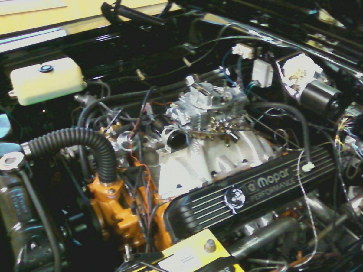

I'm running the edebrock RPM intake on my 66 with the stock unsilence breather. I had to go with a shorter filter and remove the hood insulation but it fits.

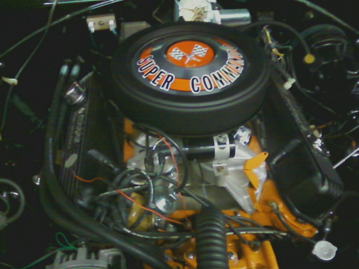

The shorter filter is the key. I went to my local parts store and they had a catalog with all of the filter sizes. I just got one that was the same diameter but was about 1 inch shorter. I can get you the part # for the filter if you need it.
Hey thanks. The part number would be great. That's nice & clean looking by the way.
Hey thanks that's when I first got it running. I changed some stuff like the rad hose since then. I will get you the part #.
