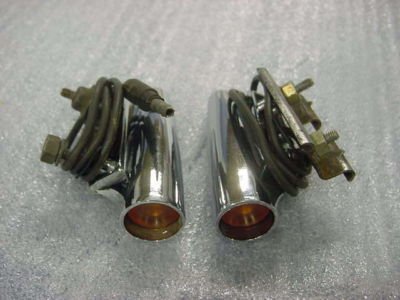

what is the best way to refinish this piece?
citadel
6:13 AM
Jan 1, 2012
191
26
Dallas, TX
These are the fender mount turn signals. I am planning to try and polish these out. Not sure if anyone has had these rechromed
To look at the picture of them, polishing should do the trick, but i have a set of these (different type) that look good in pictures, But have spider cracks all over them, these are a set I want to get re-chromed, I haven't checked on prices but they want like 300 dollars a set for these new the last i knew, it would have to be cheaper to re-chrome them. Yours look real good but there is places available that will do them for you if your wanting them re-chromed so as to look like new.. Here is one i had saved, you could call/email and maybe get a idea what way you want to go if yours are not what you want.. Good luck.
http://www.nu-chrome.com/
I got my fender mounted turn signals rechromed and they turned out great for $70. Polishing may work but if you go to far you'll end up cutting into the copper but you'll never know until you try it.
