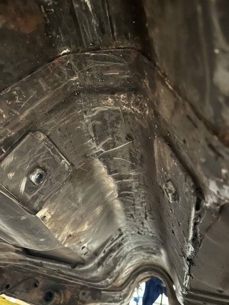

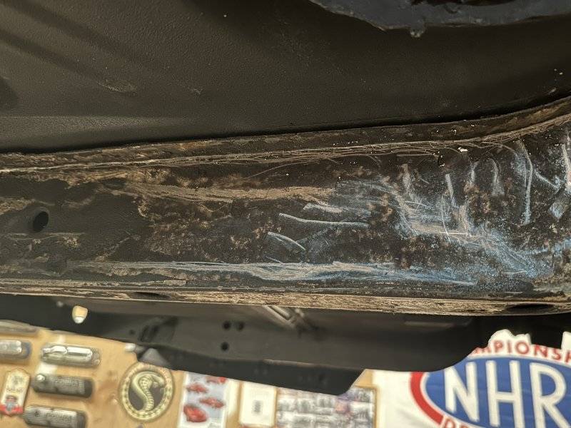

I am scraping the undercoating off with a torch and scraper, and it peels off quite easily (finding some areas needing repair under it).
Once I get it all scraped off, what is the best way to clean the surface to eventually ready for paint. I am using steel brushes of every shape and size on air and battery tools.
What worked best for you? TIA

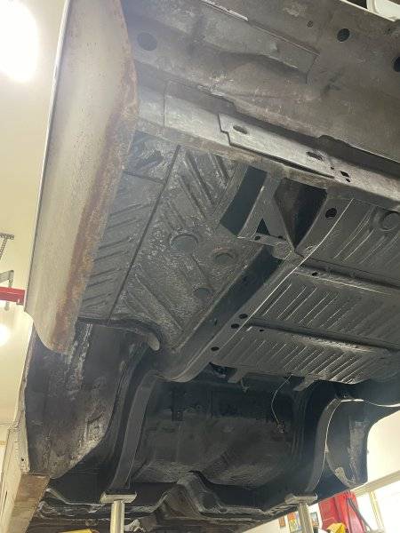

It is on a lift in my shop. Unable to use a pressure washer and wheels / drive train out so cannot move it. Thx
I used a large blue tarp to cover the floor under the car. Bought the largest hard sided plastic kid pool to catch most of the wash water. The pool was on top of some plywood and had a set of Harbor Freight moving flat dollies underneath the plywood. I brought a garden hose into the shop for rinsing. A 5 gallon bucket with deluded Simple Green was applied with an extendable car wash hd brush to scrub off what was left of undercoating.
My undercoating was hard and mostly peeled off thankfully. It didn’t need heating.
With the dollies underneath the pool easily move side to side so it would be centered below the work area.
I imagine that if you use a flammable liquid the pool would handle that for awhile. A different brush might have to be used.
The pool was easy to empty after rolling it to the outside. Good luck.
I applied new undercoating as seen along the middle of the vehicle.

Undercoating is coming off ok with heat and scraper. The task is getting it cleaned up after that.
If you plan on re undercoating it down the road, just leave alone till then. Otherwise-----
yeah not planning on going back with it except in a very few places. When I scraped some of this off I discovered serious damage in a couple places. Frame rail had been filled with foam, and in places the metal was gone but the undercoating covered it. I really want a cleaner look.
