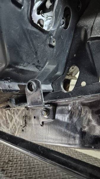

Hi all, buddy of mine has a bracket on his 1968 Charger and doesn't know what it's for.
I looked on my 1969 Charger but mine hasn't got it.
Anyone knows what's it for? Located on the left framerail, onderside firewall.
Thanks!

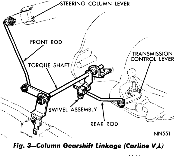

Looks like part of the auto linkage down to the shift lever for a column auto shift car
