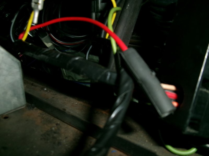

On the wiring harness for a 69 Charger with A/C what is this red wire used for? A test light shows that it has power when the key is turned on.

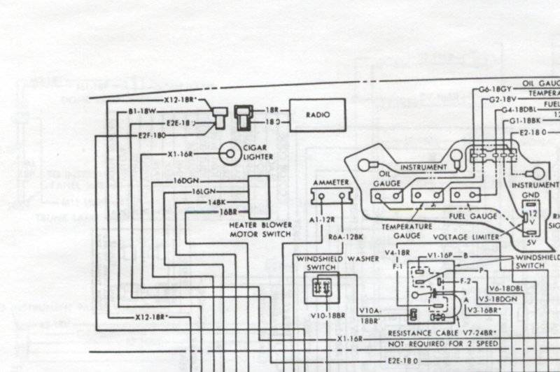

My bad, just checked and you are right! X1-16R
Traced the wire on diagram up to the fuse box and is interesting The red wire splices into the same fuse clip terminal of the rest of hot circuit being pink!
Now I see why I recall the cigar lighter wire being pink!
Same as the second gen arrives being red, but splices from there becoming pink to feed the rest of accs from same batt network, when on 2nd gens these two wires are spliced straight from fuse
(Pic taken from an eBay 71 harness)
