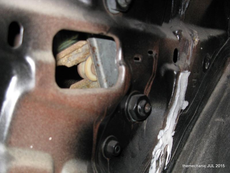

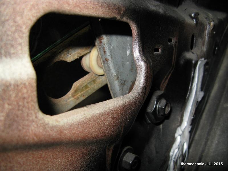

I'm working on my 1969 Coronet 2 door hardtop.
I need a roller for the rear track of my quarter window.
Looks like this:

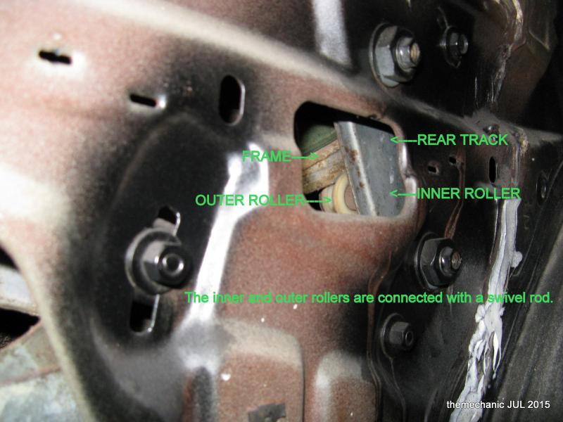

I need the part that has a roller on both ends and swivels. One roller goes in the rear track and the other in the aluminum frame.

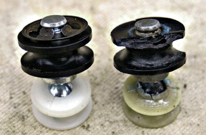

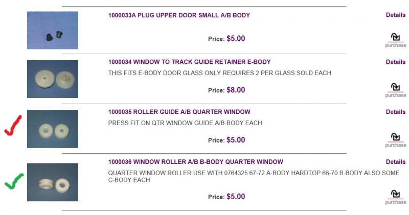

Actually the link that Bandit posted is the part you need, well sort of. It's a double roller shaft with one of the two rollers included. Which is the press on roller the smaller diameter of the two. For some reason they do not sell the whole double swivel roller. R/T Specialties sells the same part as Mr Moparts.
Okay for the second roller of the two it's attached by a spring clip in which you would have to buy the roller and the spring clip. And that would complete the set. R/T Specialties does sell the roller separate. Not sure about the spring clip. I've attached a screenshot pic of the page from R/T Specialties as well as the link to that page. There I have two different rollers in the pic. The roller that attaches with the clip is part no. 100036 (green check mark) that sells for $5.00. R/T Specialties also sells the same roller shaft as Mr Moparts (same page closer to the top, part #0764325) for $15.00. Then you would need that clip.

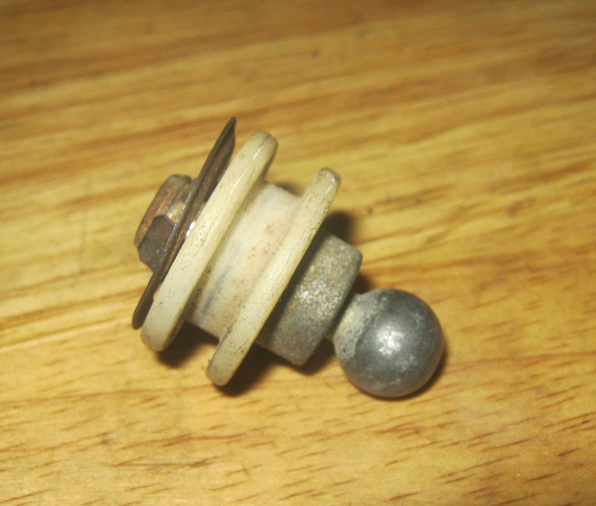

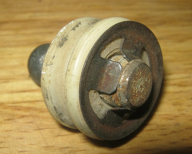

Finally I've attached two pics of the same roller that I have an extra one of. But my roller shaft needs the press on roller part no. 1000035 (red check mark) but then you would not have to buy a clip or find one.
$10.00 shipped.
Let me make myself clear as my intentions of replying to this topic was not strictly to sell you a part. I'm simply pointing out what your question asked by helping you see how it works.
