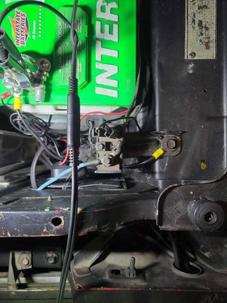

I can't find a reference in the electrical diagrams to this relay on my 67 Satellite, mounted off inner fender.
It looks alot like the stater relay that's at the firewall but has a wire to positive battery side and an inline fuse to the headlight harness?
That is the old school way of adding a relay to the headlamps.Takes the load off the headlamp switch.
Now a days they use the little black plug in relays for just about everything.
