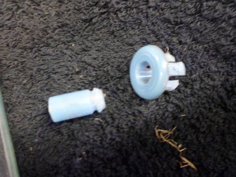

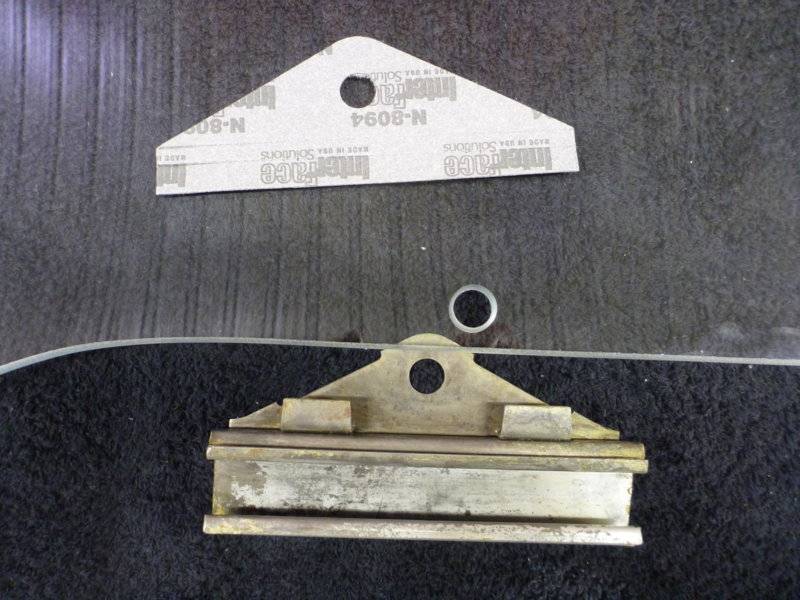

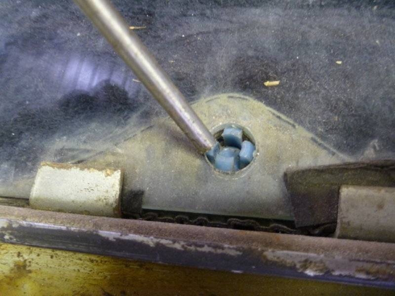

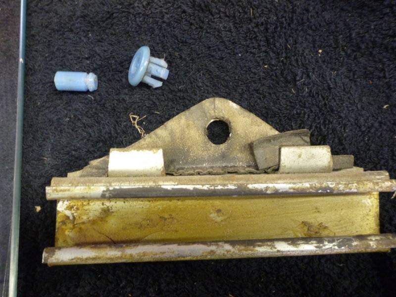

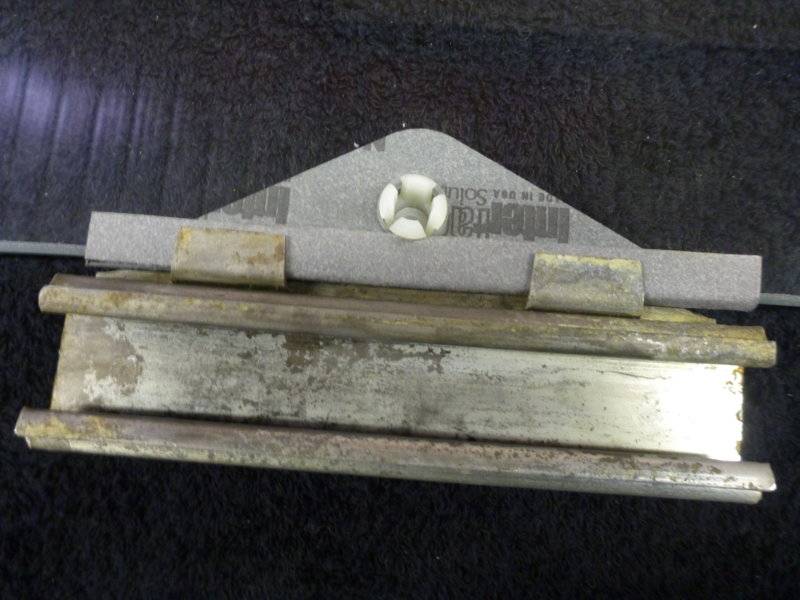

The gasket from glass to metal bracket is just made from regular sheet gasket, you remove the center of the plastic rivet to remove it, disassemble, install new gasket and then put the plastic rivet back in. Numerous restoration threads showing this on this forum...

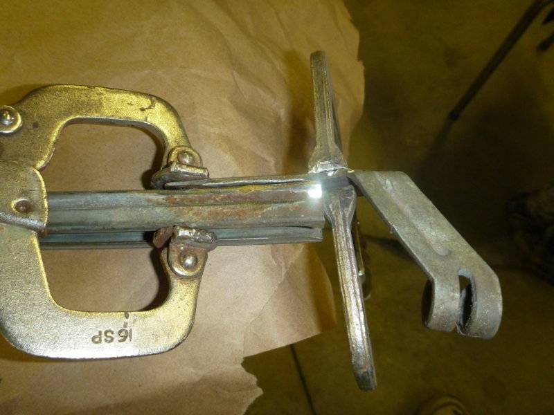

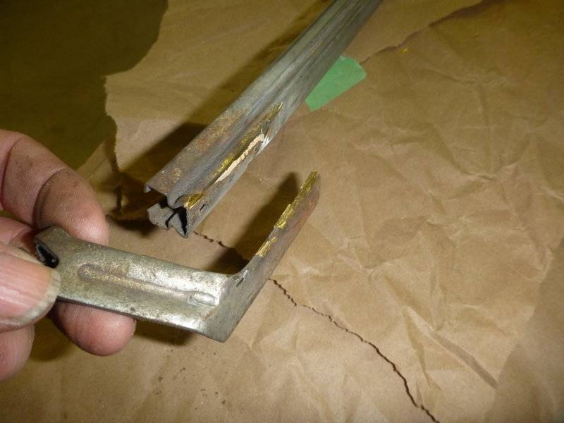

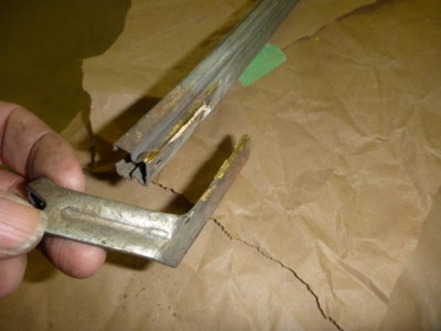

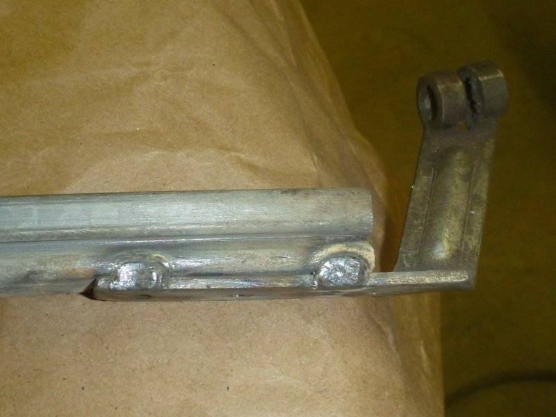

..and on the vent frame lower bracket, again covered numerous times. They break off and you weld them back on.
beerestoration2019 2671.JPG beerestoration2019 2672.JPG beerestoration2019 2674.JPG
Thank you, bud. You’re always a helpful person. I know those rivets are going to explode as soon as I touch them. Already broke and replaced a few plastic parts I didn’t want to because they were so brittle. Part of the game I guess, lol !
Give the CENTER pin a hit from one side with a punch.. if it doesn't move hit it from the other side and it will come out in one direction or the other.
Will do, thank you for helping. Seems like a pretty easy repair.
