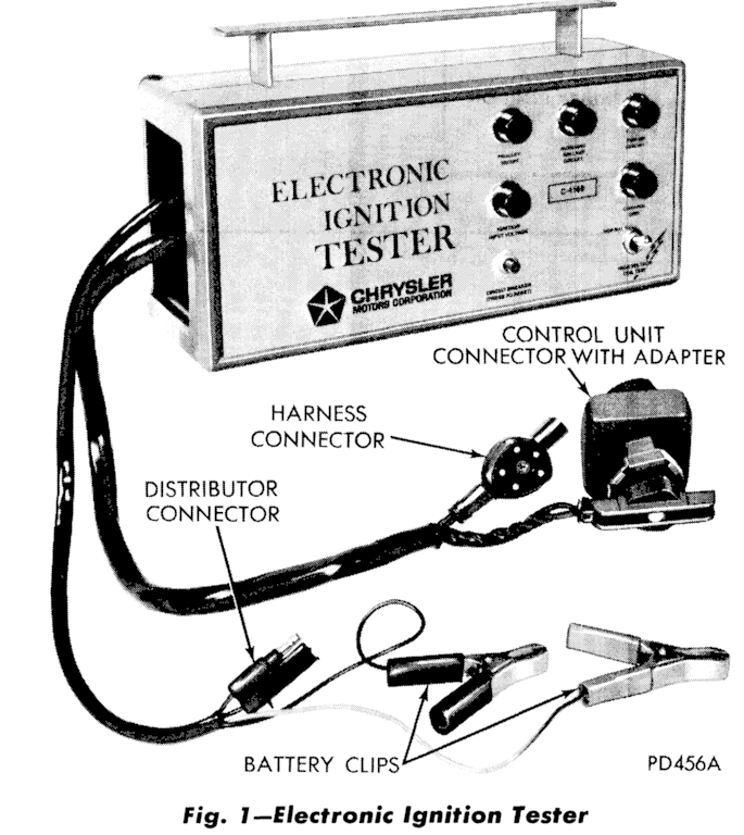

Can a Mopar orange box be benched tested ?
I imagine it would be tough to test without special test equipment.

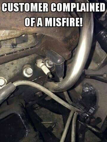

Maybe this is the problem ??
