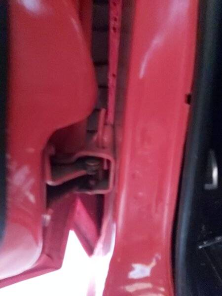

Looking at re-pinning the door hinges on my 71. The lower hinges on mine have the "S" shaped spring - in other words look more like a '70 B body or E Body. Were they interchangeable? Does anyone have any idea what gives here?
The top hinges look to be correct when comparing photos on the web.

Mine look similar to this. View attachment 971528 upload_2020-7-5_21-5-33.jpeg

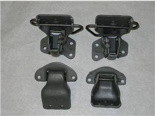

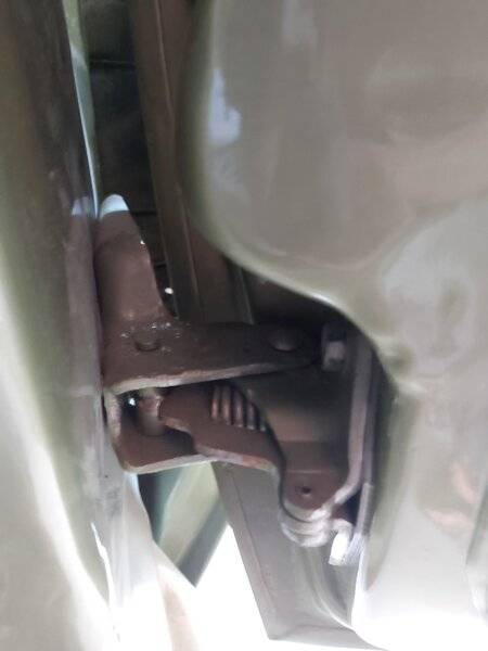

I do not know if they interchange. Someone here will know. Here is what is on my 71 Charger's. This is interesting. One car has the s spring and one car does not. A number of years ago I bought a restored kit from year one but there was a larger core charge, so I sent my originals back when the new ones came. I will check the FSM to see what it says. The first picture is what Year One sent me.

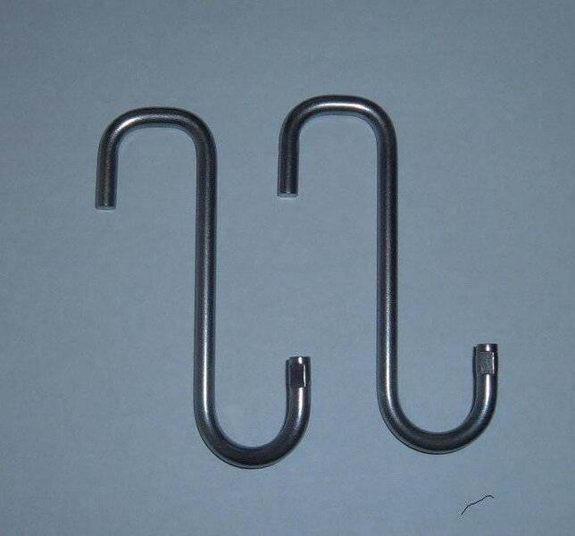

71-3 used a coil spring and was change to an S spring for 74-up. The replacements had the S spring. Yours were probably changed at some point. If you don't care about "correctness" the later S spring is the better hinge.

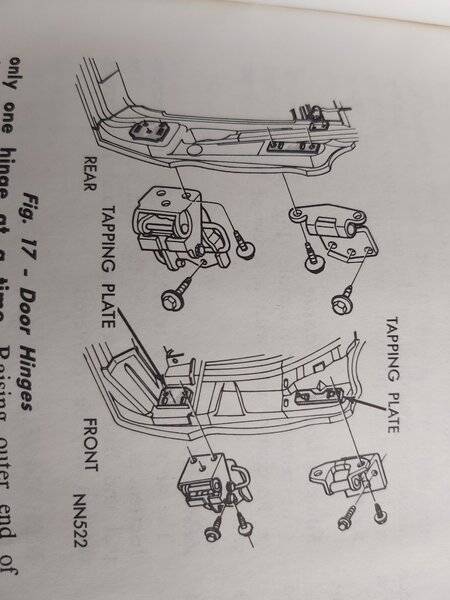

FSM shows the S Spring on both B Body and E. Just not sure if they are the same. Year One shows two different part numbers.

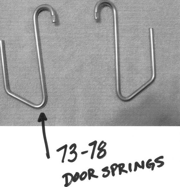

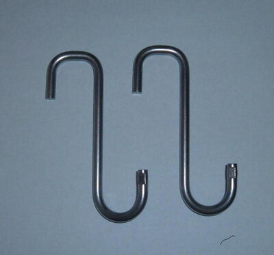

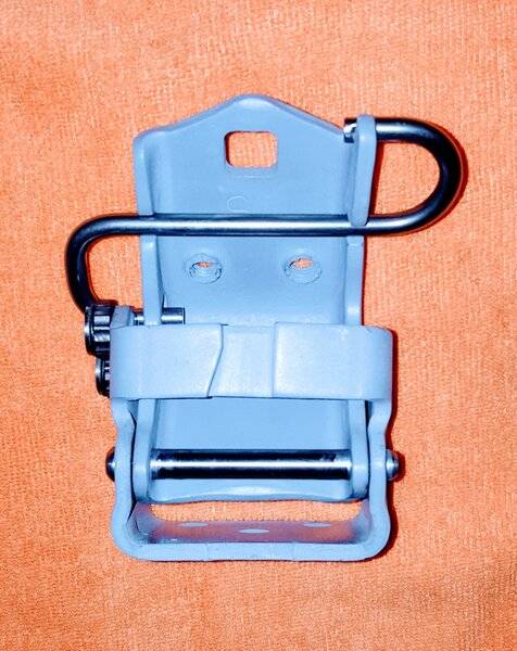

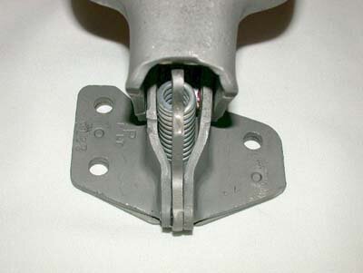

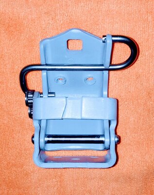

Here are some pics of a 71-73 B-body and the 74-78 B-body. The last picture is a rebuilt 67-70 B-body . The 71 and 74 will interchange but the 67-70 will definitely not work.
The FSM uses the same pictures in both Service manuals. They are the B-body front hinge. Same procedure to install and adjust so the same illustration is used.

From above the following is what I have:
74-78 B Body Hinges.
Had a closer look at them today. 3 out of 4 have already been re-bushed - should be straight forward to do those again. The one that hasn't been re-bushed is the one that is particularly bad (lower right) - but in the end just 2 holes to drill plumb and square. Looks like any pin and bush kit for Mopar will work - such as Dorman 38382 or AMD X521-1000-S.
