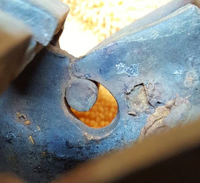

How could I tell if ones that are being sold are rebuildable? Don’t want to purchase ones just to be told they are worn out and can’t be rebuilt.

Here are some pictures of whhat to look for.
And the lower pivot pin holes must not be worn beyond .400 .
