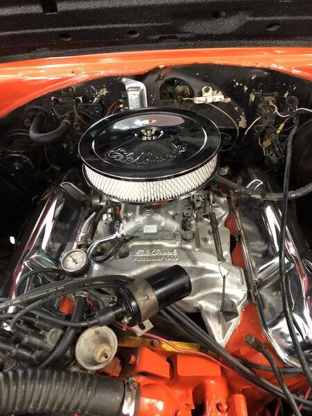

This is a dumb question but what makes an engine a Magnum. I have a 66 Charger with a 440 engine. I wanted to change out the decals from 383 to 440 but the only ones I found say 440 Magnum. Are all 440 Magnums? If not how do I know if mine is?
A magnum was the high output version. Different cam, exh manifolds, carb, valve springs etc.
What does the stamping pad show right beside the dist hold down clamp.
Looks like an older RB
Heads were also different on '67 Magnum, with better ports and bigger exhaust valves. Starting in 1968, to 1971, all big blocks got same "906" heads. Also Magnum motors got an oil windage tray. Engine i.d. pad would be stamped HP.
Mine is not a HP motor, so it is not a Magnum. Hmmm, I wonder if I can snap off the word Magnum from my $100 emblems!!!!!
