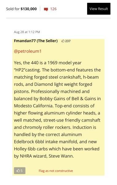

I didn’t mean your case, or every case. After all these years... you can’t go by stamped letters on a pad as to what is inside the engine. I have two F440 engines, one stamped HP the other stamped HP2. The both have forged pistons, installed at a rebuild. No 383 or 440 ever came with forged pistons. They all had cast pistons.
This car sold on BAT recently.
1969 Plymouth Road Runner A12 440+6 4-Speed
The guy owned the car 11 years. So I’d think he knew a bit about it. But in the comments he says the engine is an “HP2” casting. It’s just a 440 block that got stamped HP2.

Isn’t HP2 the second shift?

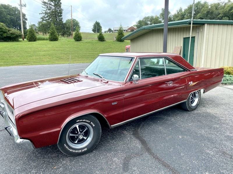

My 67 Coronet R/T has the original engine that had never been apart until I tore into it in 1987 or so. It does not have the windage tray that is mentioned. I assume those must have started in 68 or 69. As for the 440 Magnum emblems, the R/Ts did not have them in 67, but they came on Chargers. However, I like the look of them, so I added them to my car. Most people don't know they are not original...(Present company excepted! LOL)
