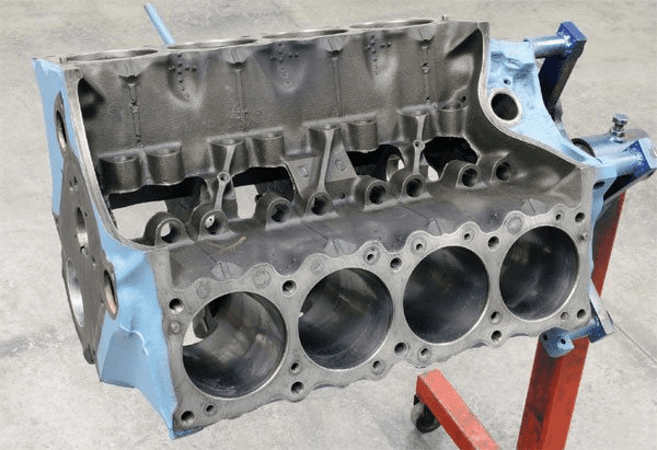

So I’m asking this question because I’m wondering what are some of the details of let’s say the Chrysler LA small block that makes it different than a GM small block from the builders perspective.
Can a Chrysler guy build a good GM engine and can a GM guy build a good Chrysler engine? This when considering to have your engine rebuilt should it be by a Chrysler guy? What is a Chrysler guy?

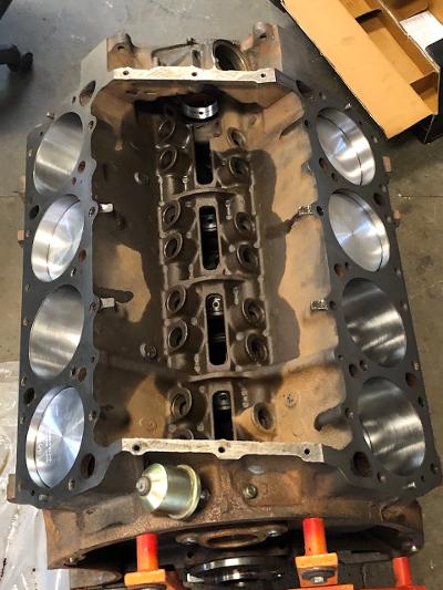

This for example came about when I was going through my heads. I noticed that the rocker arm shafts were not put in correctly. There’s a notch in them that shows correct orientation. I didn’t know this at the time, but I did notice that when I checked for oil flow during priming, the lifters weren’t getting correct or any flow. After investigating, I realized the shafts were reversed, and the oil holes were not lining up. An experienced Chrysler guy would know this right away, but a GM guy might not.
So what other main differences or minor peculiarities are there? Can a GM guy easily build a Chrysler engine if he’s a competent machinist and builder or is there something inherently different about Chrysler engines versus GM engines?

I guess I’m looking for the details as I stated above as to what makes these blocks and heads that much different. I know on the LA engine lifter angles are much more pronounced, but it’s stuff like that. I’d like to understand better.
I also understand that a Chevy guy may not know the right combination of cam specs, and compression ratio deck, height, and piston, exposure, etc., that an experienced guy would know. And maybe that’s the real extent of this whole question is just getting the right combination??

Rocker shafts are oiled by the head. If the lifters were not getting oil, you have the wrong lifters.
A mopar engine builder would know that. So would a good machinist. But wrong lifters are advertised as fitting, so there is that.
