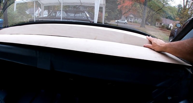

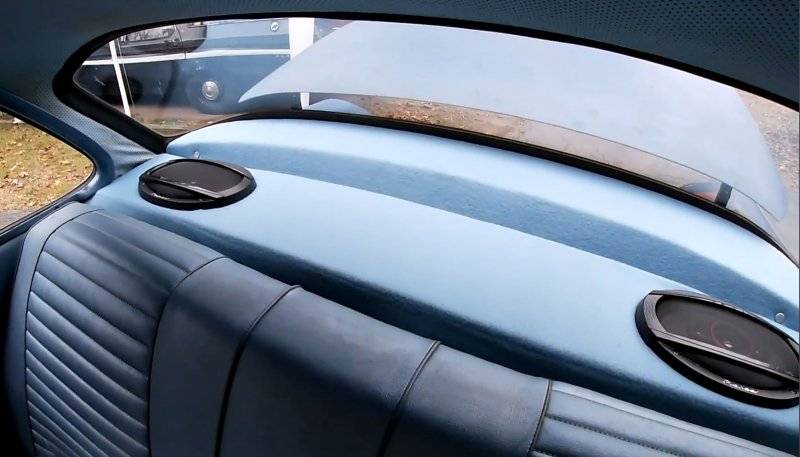

I made a package tray for my Valiant using very thin plywood wrapped with material from a craft store.
Plywood was very inexpensive, material was $17 for a half roll, which was more than what was needed.
I need a headliner as well for my 62 Dart, last thing to finish my interior. I might use my own idea on that too.

looks good for low bucks !
