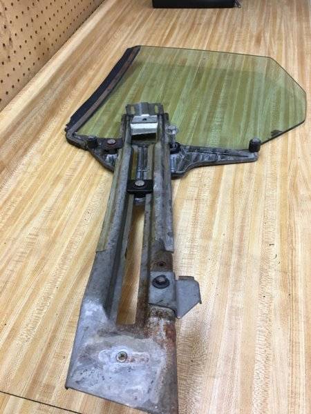

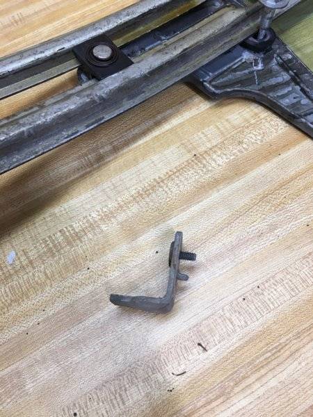

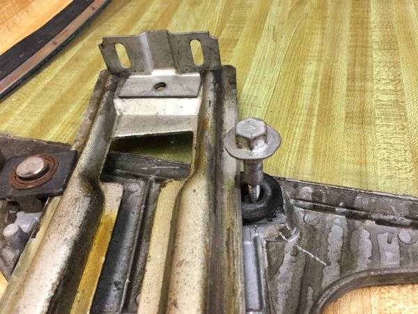

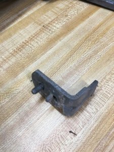

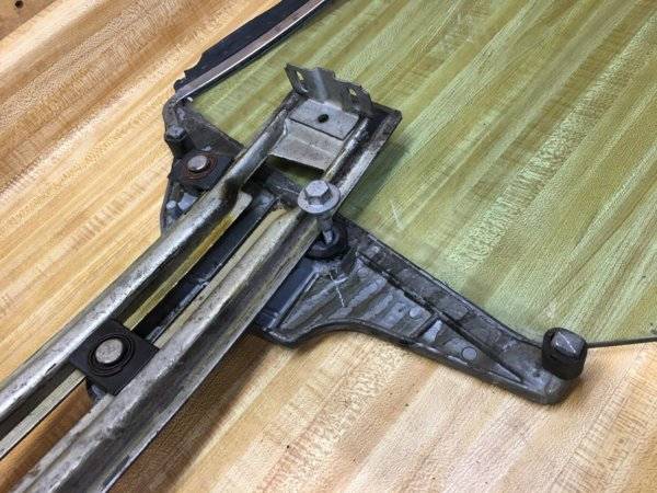

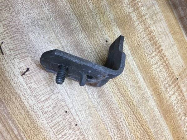

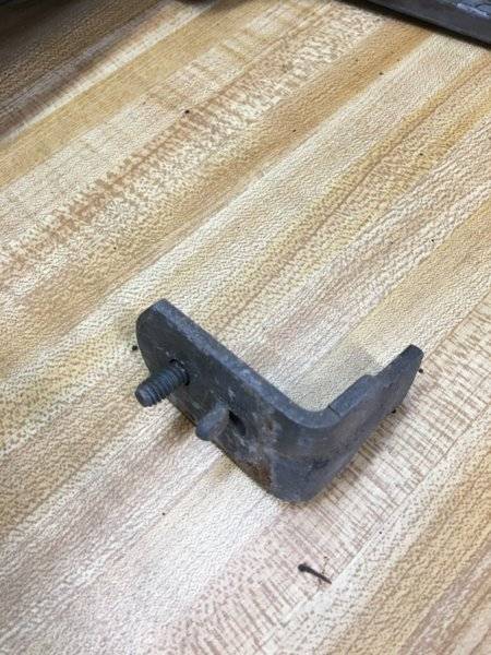

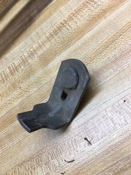

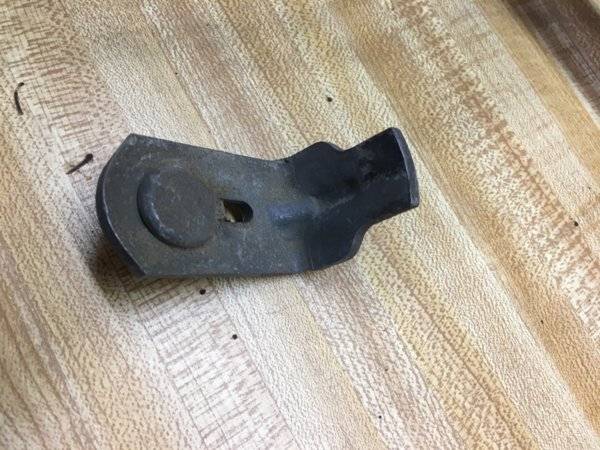

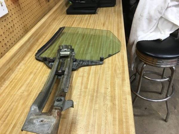

putting the rear side glass in my 1971 Hardtop Roadrunner, can someone tell me what i'm missing, I have the other side in but something is not right, where is the splined piece that connects to the rear door handle, I looked at the Body/Chasis manual it shows a pivot arm, is that missing on my assembly?? Also what is the L bracket pictured? Where does it go??

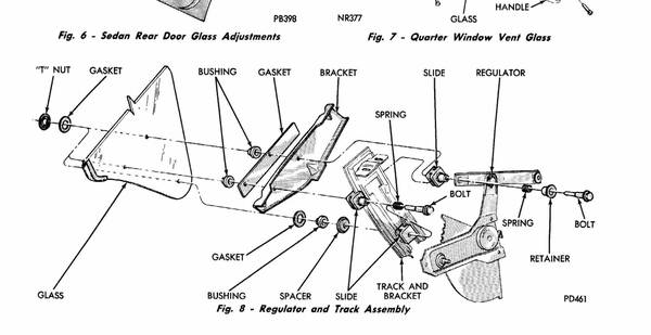

The brackets are up-stops, they bolt in inner body structure, two per side. Appears the third slider is missing. Regulator connects to a pivot arm that rides in a channel welded to the inner structure.
Page 6-25 of the ’71 Plymouth Body manual shows a pretty clear picture. Although the glass is different in ’72, most of the mechanism layout is the same, a better picture is on page 6-24 of the ’72 body manual.
The brackets are up-stops, they bolt in inner body structure, two per side. Appears the third slider is missing. Regulator connect to a pivot arm that rides in a channel welded to the inner structure.
Page 6-25 of the ’71 Plymouth Body manual show a pretty clear picture. Although the glass is different in ’72, most of the mechanism layout is the same, a better picture is on page 6-24 of the ’72 body manual.
thank you bro.. looks like im missing regulator and pivot shaft, thank you so much
