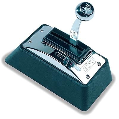

I've had best luck with the B&M Quicksilver
I had one in my last 68 RR too, for over 10 years trouble free,
I did lube it a couple times out of precautionary measures, not sure if it actually needed it...
Just keep the cable in a wide arch, no tight bends & away from the headers...
not the best for racing maybe but trouble free on the street in several cars,
never had any issues at the track or tech either...
You can have a forward or reverse pattern too
I had one, inside a 68 B-Body Console "sort of" too
thru the OE hole area ,top plate removed & used the B&M trim cut down to fit
I've tried a bunch of different new trick best of the best {not} ones over the years
& I keep going back to the Quicksliver...
Not the most expensive or the best maybe, but I stick with what I know works,
that hasn't stranded me or fell apart, we'll see I have a new one for my current 68 RR too...

I'm with Budnicks, the B&M Quicksilver is a great street friendly ratchet shifter. I hate grabbing knobs, levers, etc so having the lockout where simply lifting the whole handle makes more sense to me.
Had one in my Charger while it was still an auto and never missed a skip, perfect shifts everytime.

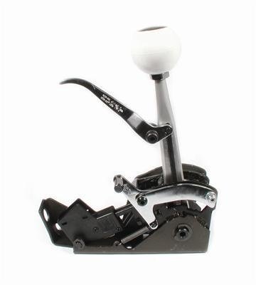

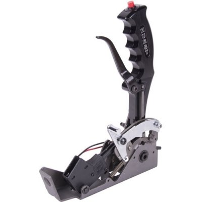

I had good luck with the old Hurst Quarter-stick $269 too,
they have a newer version with a pistol grip $362
Hurst Quarter Stick hur-3160009_8769 $269.jpg Hurst Quarter Stick Pistol Grip TF-530-316-2015 $362.jpg

I love my quarter stick. I wrapped the cable with header wrap and layers of that 3M heat foil tape. Never had an issue and never miss a shift. Fits my console well too.
