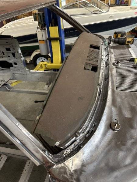

I've cleaned up the windshield frame and repaired the corners and am moving back to the dash. My questions are:
1) The dash is in really good shape and I'd rather not remove it; thoughts?
2) Do I simply continue stripping the dash as I've been doing with the rest of the car? (I can see no reason why I shouldn't.)
3) What paint do I use to paint the dash? (I'm assuming I spray the epoxy primer followed by a couple of coats of matte black.)
That's it for now. Thanks! Terry
I would remove it. It's easy, and you're this far in. Bolting in a freshly restored dash assembly is very rewarding.
Once the windshield is out the dash unbolts easily.
Get it out of there so it doesn't get any overspray or other damage from the car painting.
You may want to test the gages and for paint on the dash, there are proper paints out there. Look at some threads on this site for info. Gotta be some here.

Remove the dash and refinish it. You have the car torn that far apart, now would be the time to do it...

Okay, out it comes. Thanks for the advice.
