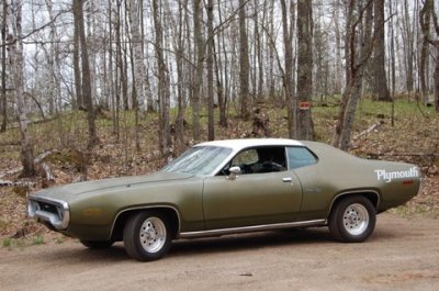

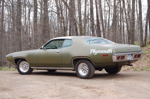

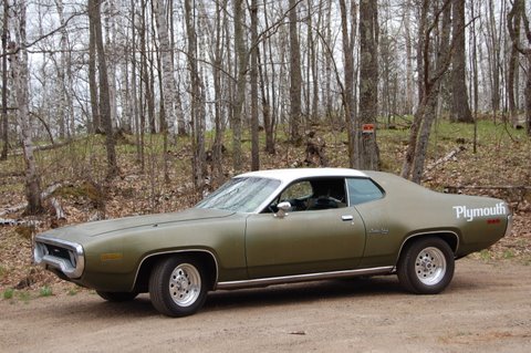

Looks like im going with a double pumper,, thaks everyone for helping decide on the size 750,,new here but i'll try and add a quick pic of my car
thanks everyone !!!!!
1971 Sebring Plus , origunal faded paint no rust or bondo ever, nice start for our project, actualy i kinda hate to paint it ,such nice patina
