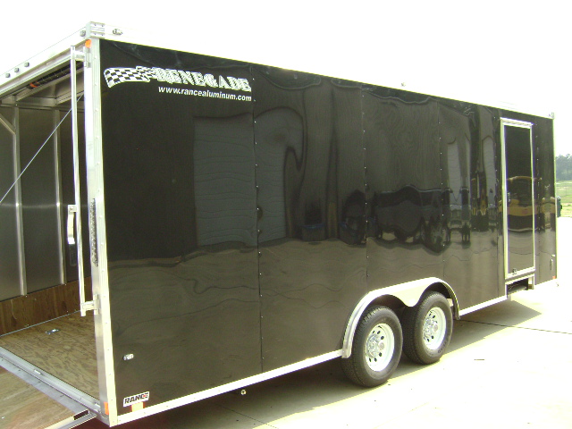

Definitely 24 ft. You will fill the space. I got a GREAT deal on this 08 Model

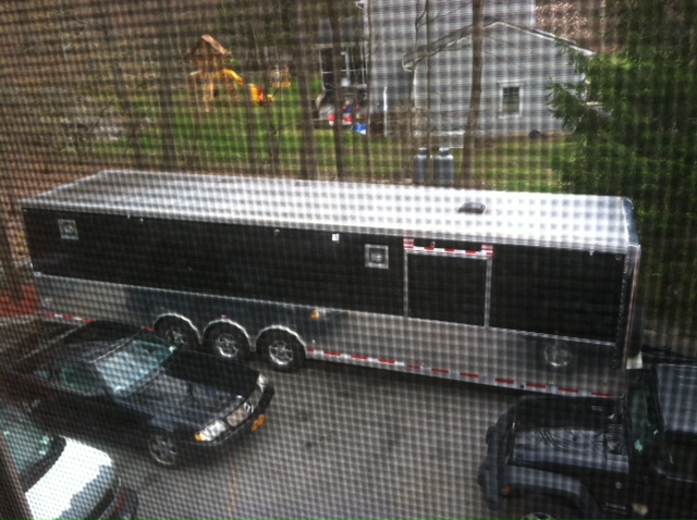

Get one big enough, mines a 34 footer and I WAS able to haul one of these around for a short time. It stunk like **** after it got out.

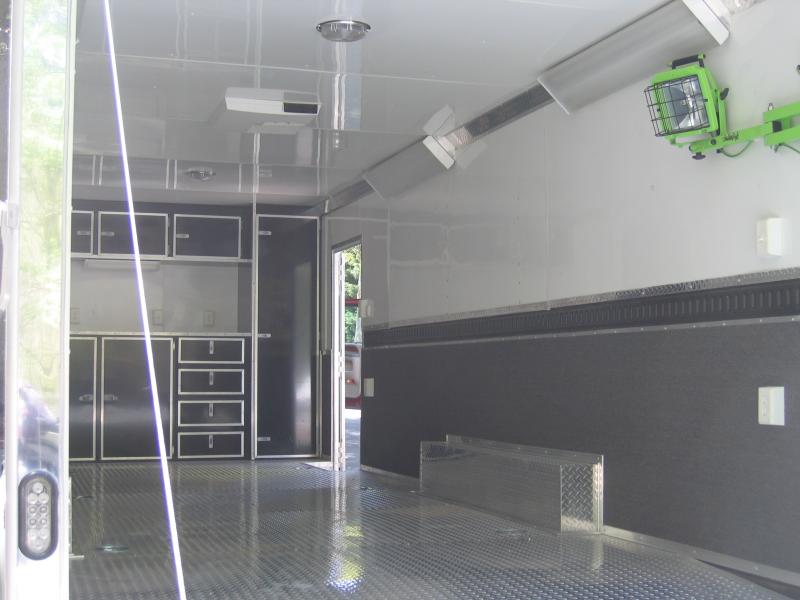

Here's mine
