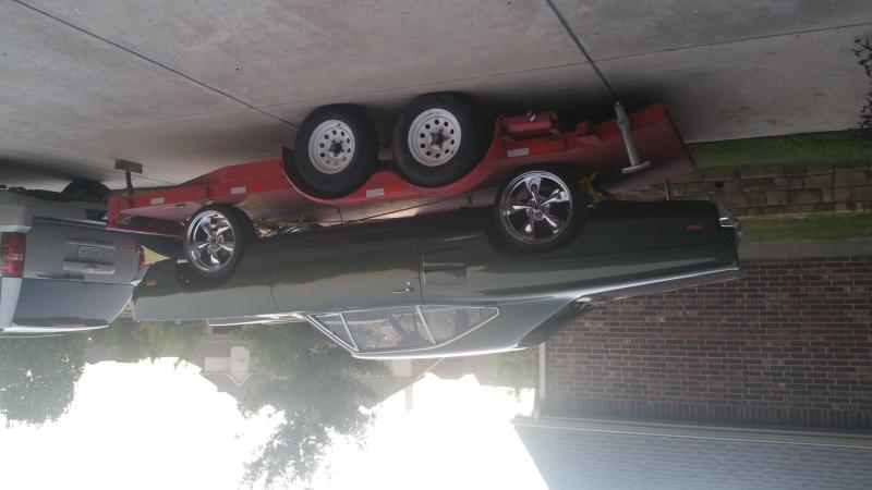

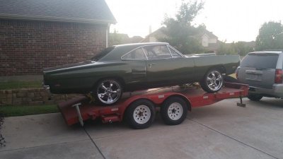

I recently got my 1969 Coronet out of the paint shop. It time to build motor and im totally confused. The car has a 489 pos. With 4.10 gears but i want a driver and not a race car but I dont want a slug either. The motor I have is 68 440 with 906 heads. I have a mopar performance dual plane intake and 850 demon carb. I dont know what to use for cam or convetor,the motor will be bored 30 over. Im really a fan of dependability. Thanks
