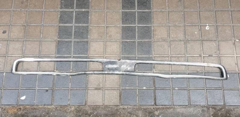

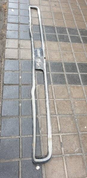

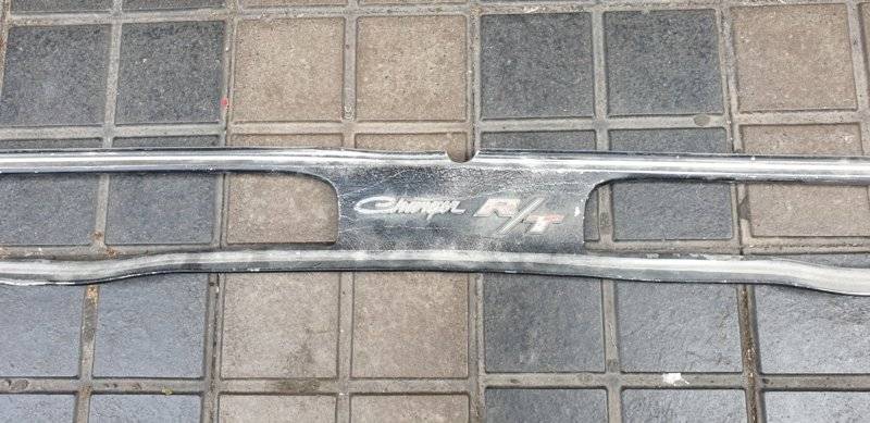

Hello friends, I have a 1970 Charger RT and I need this part back to life. Car is located in Europe and my options now are: buying a new one (I haven't found it yet), restoring mine or making something new. What do you think? Any advice is welcome.
Thanks in advance.
Hammer, dolly and lots of hours.. it CAN be done. See my Bee restoration thread for ideas...

Thanks for the reply. Car is in Spain, so shipping there and back would be very expensive. I guess restoring will be the most logic option.
Do you know if they sell it (or reproduction)?
Do you know if they sell it (or reproduction) anyway?
very expensive? you are restoring a Mopar.......whatever shipping may cost is a drop in the bucket
No reproduction & NOS is rare & $$$$ I'm sure there are tradesmen in Spain fully capable of making that part beautiful... I know when I lived there in the late 60's there were some very skilled guys... If you could get them to work.. Mostly I heard siesta & mañana... LOL

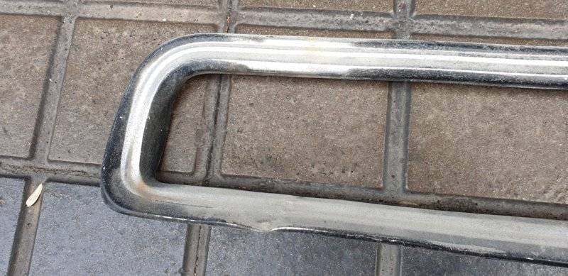

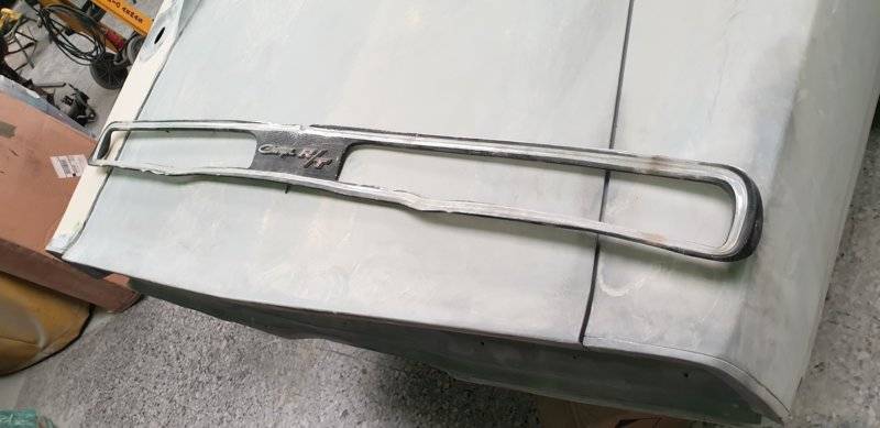

@HEMI-ITIS- Those panels are stamped aluminum, brite anodized all over and paint detailed in specific areas. If high point restoration is the goal in my experience re-anodizing is the most difficult thing to find a suitable vendor for. Of late my aluminum trim ends up polished after straightening. Looks fine, but must be re-polished to keep shiny vs anodizing which can be wiped off with a rag and maintain it's shine for years. If anyone knows of an anodizer catering to the hobbiest please post their name/number here. Plenty of commercial anodizers in Los Angeles/Phoenix/etc. but they do not wantal with the onsy twosy irreplaceable parts of the hobbiest.

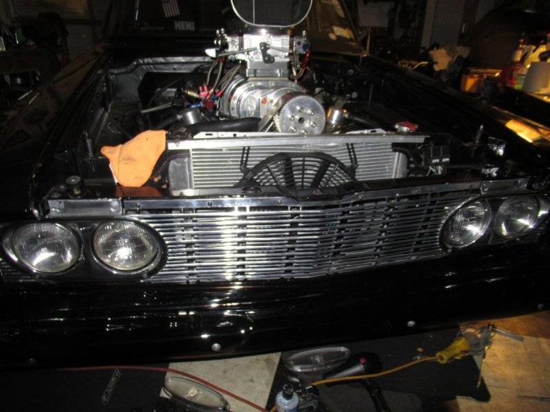

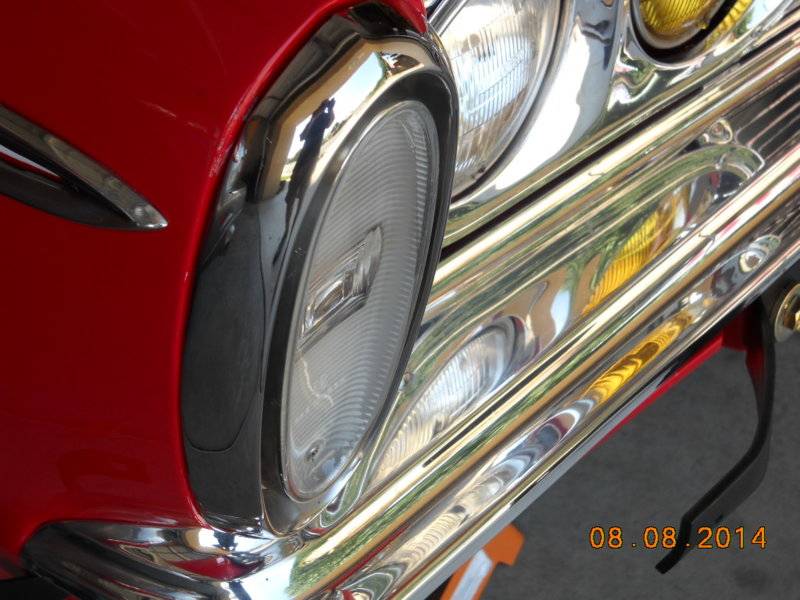

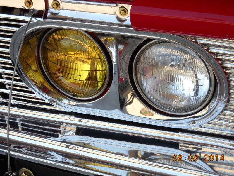

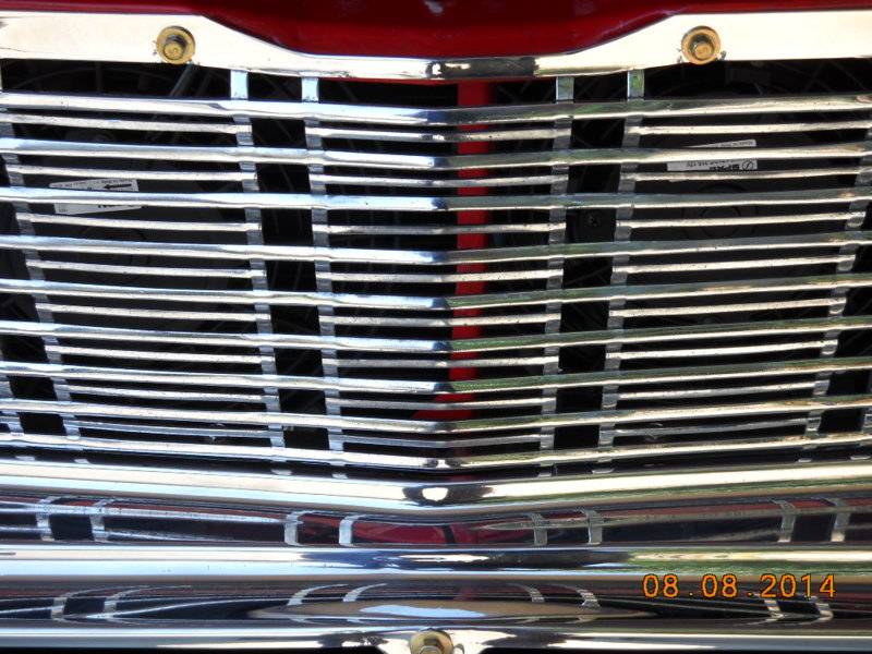

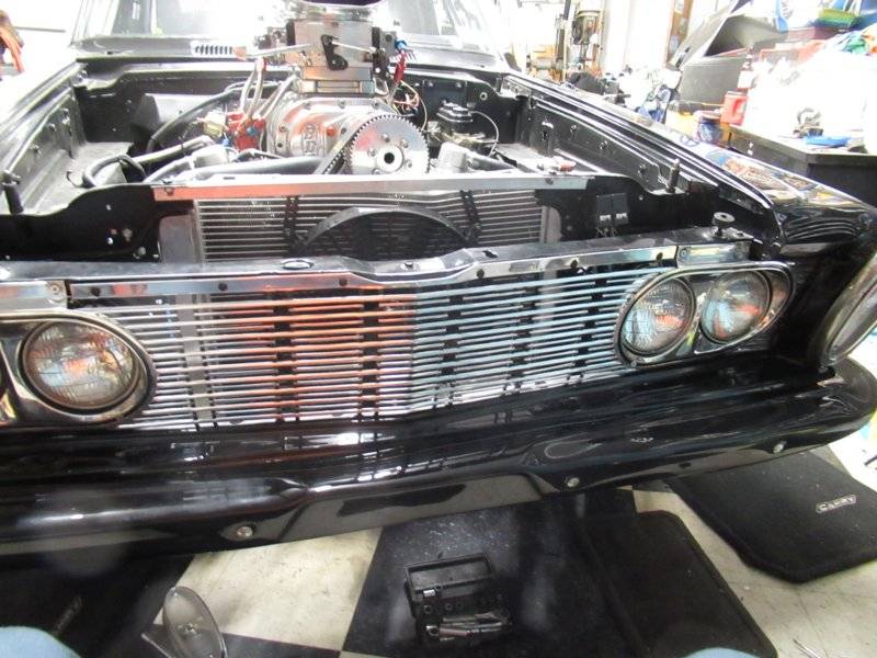

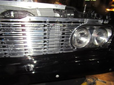

5.7 HEMI here on the board did my 3 piece grille and headlight bezels.The bezels had some ding and he took care of that too. I personally like the polished aluminum over the anabrite. Contact Zak and you will be as happy !!!
7.1.18 grille 001.jpg 7.1.18 grille 007.jpg 7.1.18 grille 008.jpg 7.1.18 grille 009.jpg Carlisle 2019 333.jpg
I have used Bill Petrow at Special T's Unlimited in the Chicago area. They specialize in 62-65 Mopars but do all sorts of trim resto. I was happy with their work on my aluminum side mouldings. They straightened and re-anodized them. Not cheap but good work seldom is.

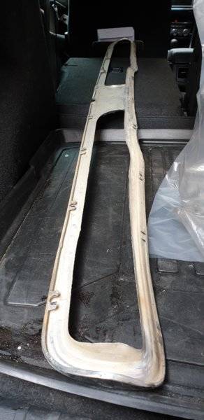

I got an specialist where I live that´s gonna restore it. Budget is 400 dollars (redone the aluminum and rechrome it). I will tell you the results. Thanks everyone for your help!
