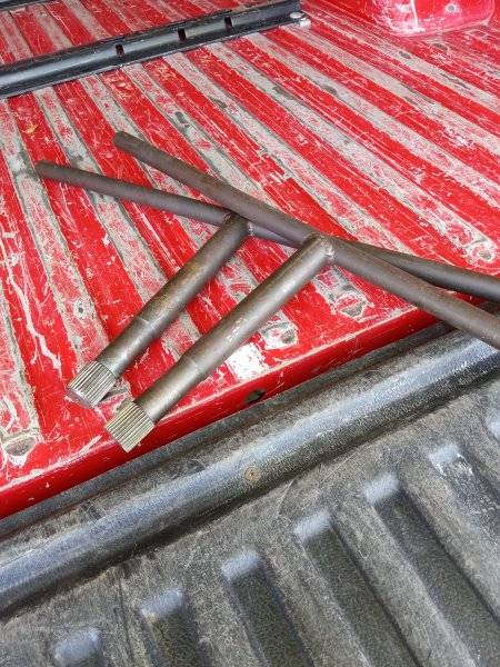

This is what I stuck together for going to the swap meets years ago. Any units that had at least some resistance (especially cone types) I would buy but yeah, I liked the ones that were tight but a dry one would be tight even with a lot of wear. Tools of the trade below :D
