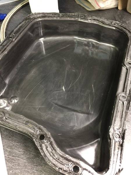

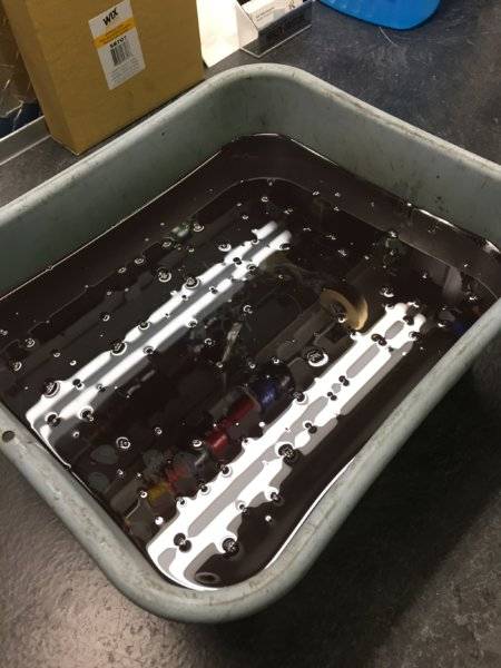

Update. Dropped the trans oil today and it wasn't good. Dark, tainted with metallic grey and odor is stronger than it should have been. Really it was a mess. It has to come down and gone through.. This trans came with the car and was said to be fresh, fully rollerized and so on. Looks like I'm going to find out how trick this trans is soon enough.
Oil is dark, tainted with metallic grey
I wiped the pan out but the metallic remains visible
Completely not what I was expecting to see.
Malex, I am looking at one of the trans pictures posted above.

That’s what mine looked like the first time I dropped the pan.
