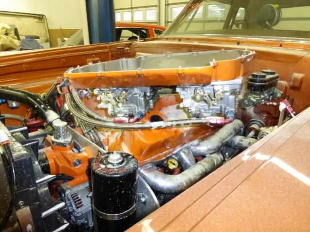

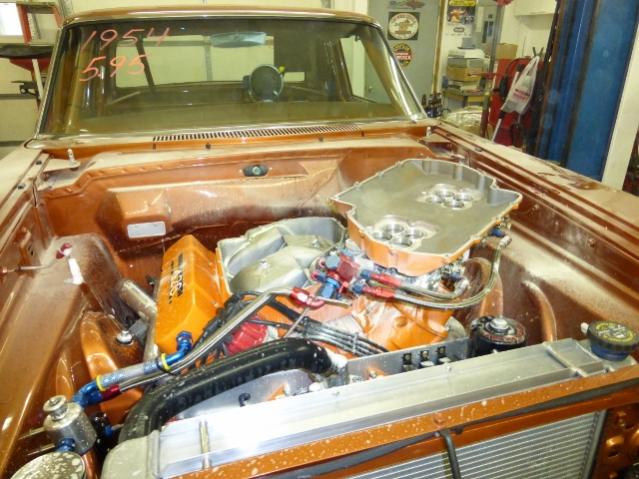

Last year after showing my car at Autorama it was time to hit the track. I had a trans issue which I quickly repaired. It had had trouble starting it a few times before. But this time it sputtered then went POP. Lesson learned, don't crank with the ignition off then flip it on. The plenum fills with fuel, and in this case the plenum is a big one.

Holy crap!!!! I have heard of this happening but never seen the results. I have an STR and the Weiand 6 BBL and you bet I'll be careful.
Oh crap is right ouch....
The worst part was clean up. I have a fire system. However the line was not quite snug at the bottle. It did put most of the fire out .But I had to hit it with the powder. That was the mess. I couldn't fined the small pieces of the broken intake bosses. So I pulled the heads, none were inside the cylinders. I had to touch up two chips in the drivers side valve cover. Replace the throttle cable and fuel line from the fender well to the regulator. Took the carbs apart, it melted one accelerator pump. All went back together fine. Went to the semi finals next trip out.
