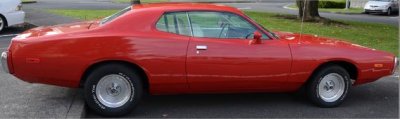

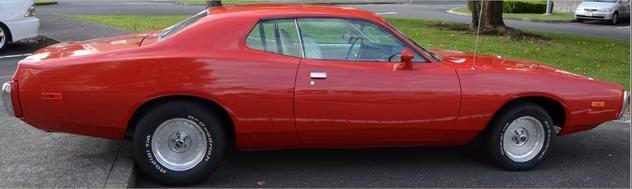

Does anyone know what is the name of these wheels? Any info about them would be great Wheel.jpg
Whoops, I forgot to upload the image.
It would be great if you posted a pic of them so we could tell ya :D
'90s American Racing sawtooth wheels, IIRC.
American Racing sold those back in the mid to late 1980's and early 1990's. I'm checking some old catalogs to see what the name of 'em was....
So I am guessing I can't just go out and buy these. I'll have to wait until they appear on eBay?
And if you have knowledge of it, what sizes/bolt pattern/offset will i need for my 73 Charger? Everything is stock now.
American Racing discontinued these wheels about the same time day-glo wiper blades went out of style. These were like the rest of the 1-piece cast aluminum wheels they offered back in the day. They were designed with a backspacing to fit a Camaro and us Mopar folks had to deal with it and run crappy narrow rims (7" or 8") with around a 3-1/2" back spacing.
You'll need 4-1/2" bolt circle for your Charger.

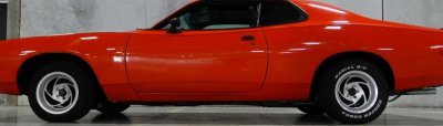

That looks familiar too, here is mine with my cheap wheels.. haha0_Charger_2.jpg
If you like those wheels, I would check around the wheel catalogs. It's tough to find an older pattern that someone isn't remaking today.
