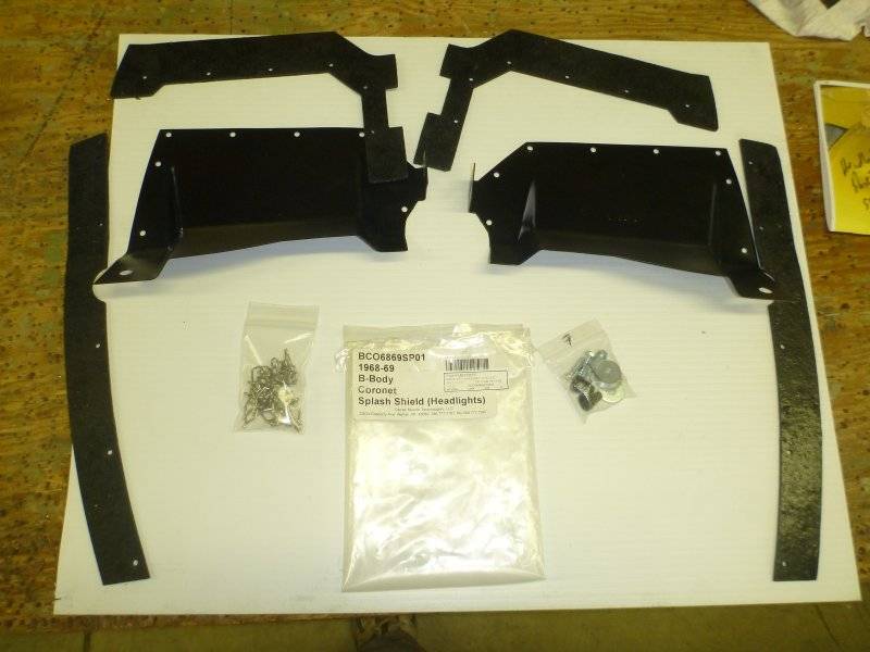

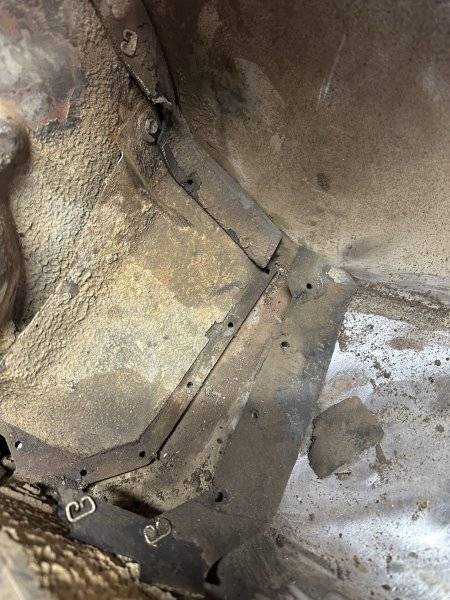

I'm restoring the fenders on my 68 Coronet and I removed these cardboard-y strips that were clipped in. I need to replace these but don't know what they're called. I know there are folks here who know. Thanks!

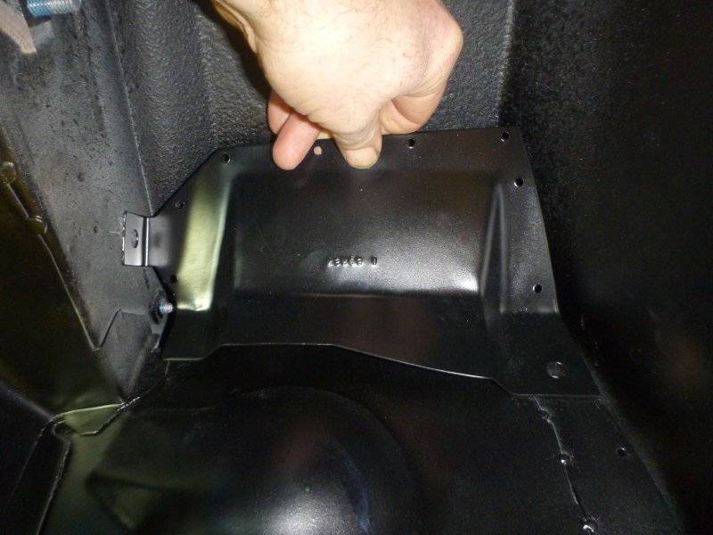

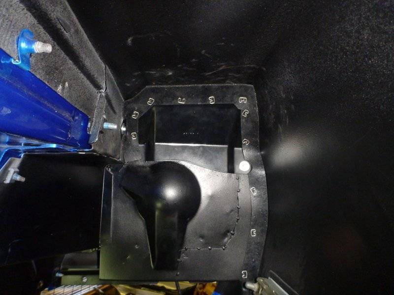

I need to replace those on my '70 Charger as well. There's a metal part called the fender splash shield that seems to clip onto the firewall and inside rear of the fender with metal push-pins. Then there's the hard rubber fender shield gaskets that clip onto that. My metal splash shield on the passenger side is rusted out. I already bought the gaskets, they're the same for '68 to '70 Dodge B-Bodies; bought them from National Moparts in Ontario, Canada:
1968-70 Dodge B-Body Front Fender Splash Shields, Pair-Repro – National Mo-Parts
This is the gasket set for a '70 B-Body, not sure if it's the same for '68/'69 though:
70 B-Body Front Fender Upper Rear Splash Shield Rubber Seals, Pair-Repro – National Mo-Parts
I need the ones for the rear of the front wheel wells so thanks for that link also. Mine is a Plymouth, but Detroit Muscle Technologies has the part I need.
