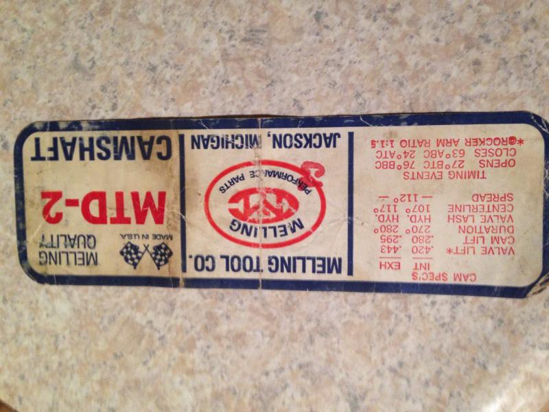

Many years ago when I was young and dumb my builder and I installed a set of 906 heads on a 66 383. Which I discovered years later don't match. So I have decided to rebuild them and have them milled to increase compression. I removed the intake and saw there were cracks on the head near a center bolt hole for the intake. So now I am thinking of getting a different set. I was hoping that you guys would have an opinion on what would be the best combination with the camshaft that Was installed in it. Or even if this is a decent cam at all. I want a set that will work with my original intake and exhaust manifolds. This is just a driver so I don't want to go too crazy.I saw that aeroheads racing offers reasonably priced heads. But are they any good? I am on a strict budget as I am married with six children.
Sorry pic is upside down.
How does it run with that camshaft? You don't like it?
Everyone will probably look at the numbers and say you need a bigger camshaft, but depending on your car and how you drive, it might be great for cruising around, running errands and hauling kids. It probably makes good manifold vacuum and low-end torque.

Car runs well. But it's more of a noisemaker than anything. The problem is the valves are burnt from running unleaded fuel. So I need to have them done but in the process I found cracks in the head. The other problem is that I have open chamber heads on a closed chamber engine. Which of course lowers the compression ratio.

There is nothing wrong with running 906 heads on 383 regardless of what year the block is. It is the components in the block that make the difference. Personally with the intake and exhaust manifolds you are running going to much a larger cam would be a waste of money and time.
