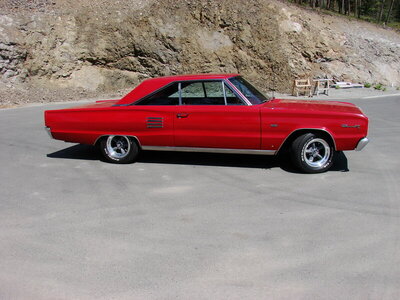

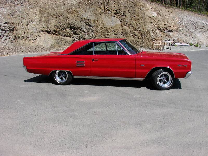

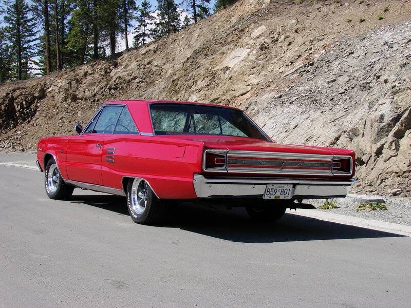

On my 66 Coronet I went with 235X60X15 on TTD's. Absolutely no rubbing ever and I put lots of miles on it. You might be able to squeeze a 245 on but I know the 235's work for sure. Stock 1966 XHD springs and torsion bars and the wheels were 15X7.

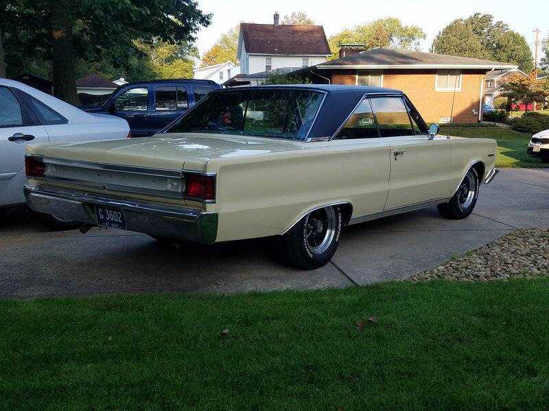

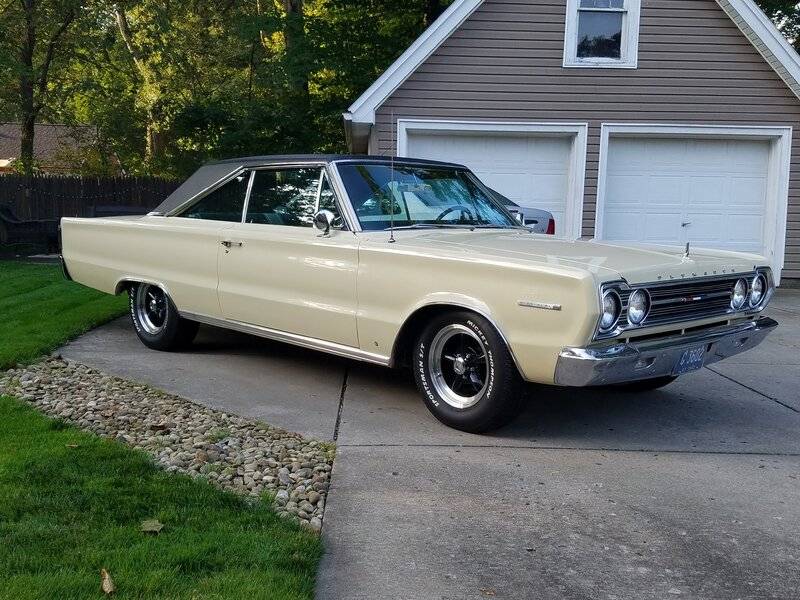

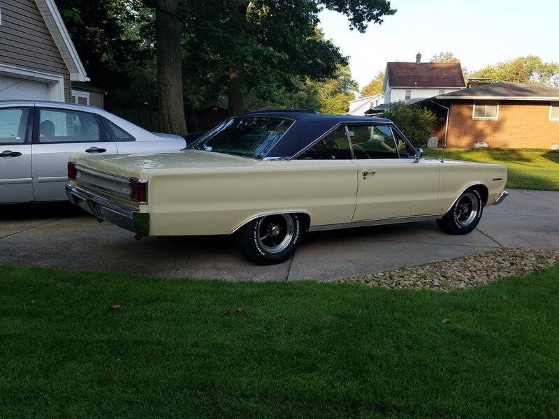

Check out a member on this site using lemonwedge as his forum name I believe he's running the wheels and tire combo your asking about
Thanks for the replies. Im currently running an 8" Ramcharger style steel wheel with 4.5 of BS and a 255-60 M/T ET Street radial which fits in there fine. I was hoping to hear that at least a 235-60 will work which it sounds like it will based on Runcharger's experience. There is no custom BS options on the American Racing Torque Thrust D's, otherwise this would be a piece of cake.
Yes: That's exactly why I did what I did. The 235's were as much as I could get on the front and I wanted the same size all the way around too. You can definetly get more tire in there but those wheels are what they are. One thing about it, I wanted the 60's-early 70's vibe so they gave that.
