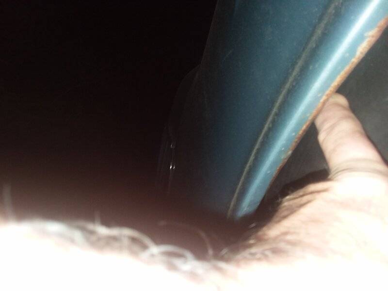

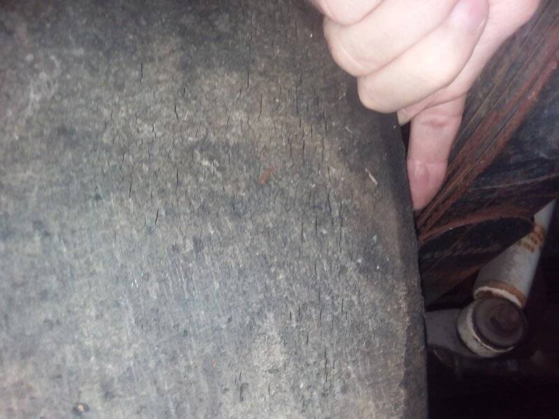

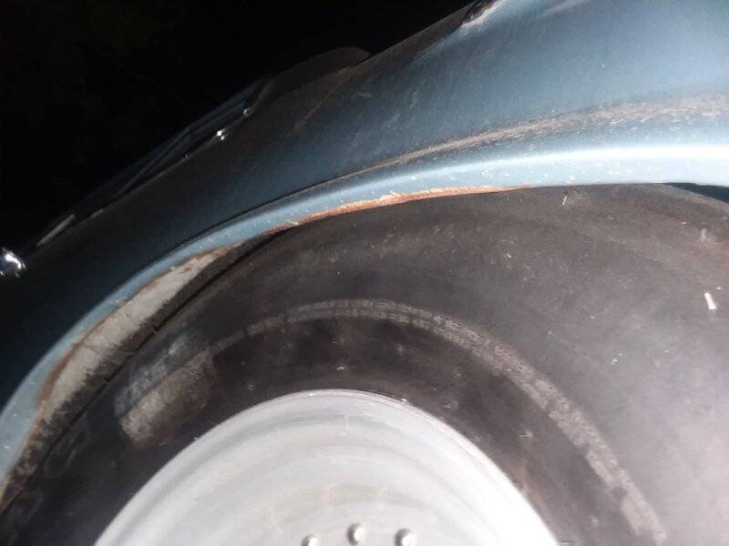

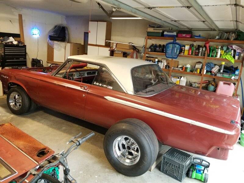

Ive got a 62 savoy with a 10.5x28 slick that barely fits with spring in the stock location. I have about a finger width to the fender, and a finger width to the springs. They are on a 15x8.5 centerline with 4 7/8 backspace, with a .300 spacer, so almost exactly 4.5 effective bs.
I also have a 10x28 slick on a 4 1/2 bs tt2, that fits much better, the 1/2 makes a lot of difference.
