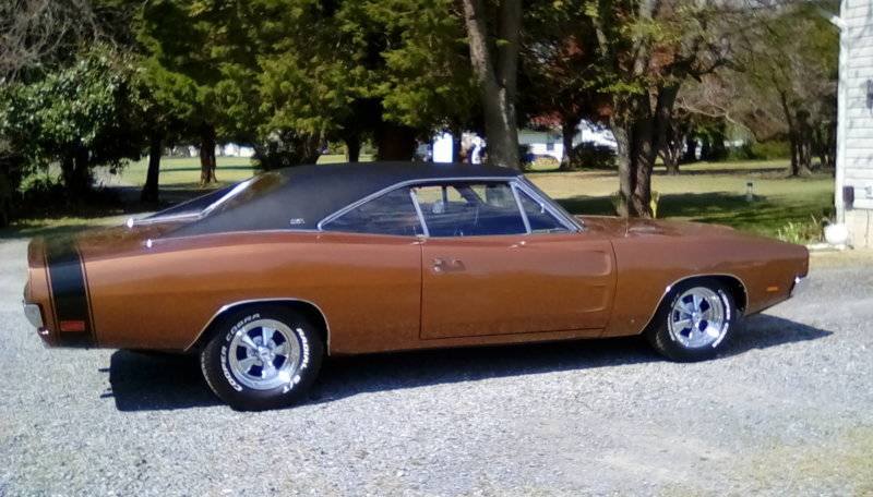

Well, got them from summit last week. I installed them the other day. I'm happy with the outcome.
