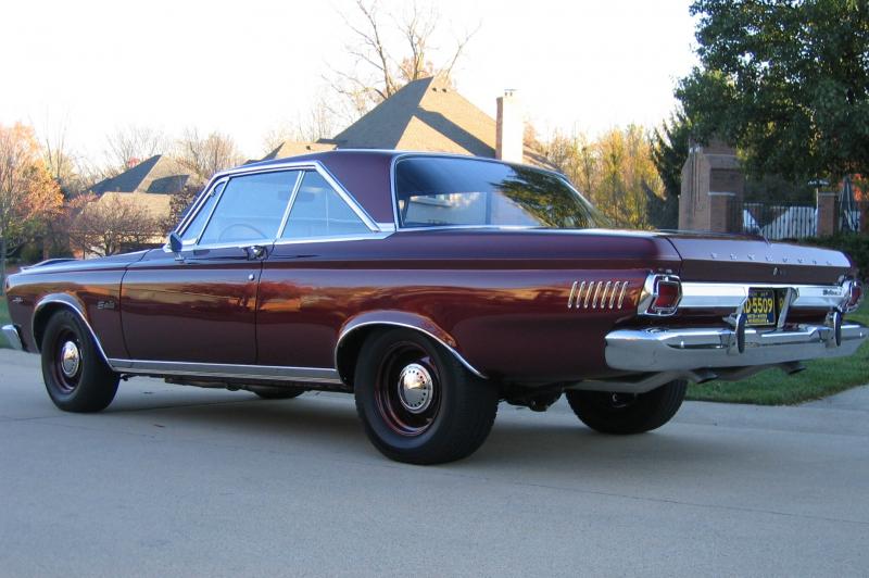

In your response to painting the wheels to match the car, I'm not sure how the factory did it in '71--they might've been black. I know in the 60's, many manufacturers painted the wheels the same color as the body. My tire sizes are 225-70-15 on 15x7 in front and 275-60-15 on 15x8 in the rear. I had the cop car dog dish caps chromed for a different appearance. Good luck, Bob
that looks perfect...
