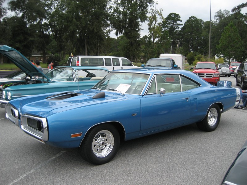

I went with the following setup
BFG radial T/A 275 60 15 on the rear with a 4.5" offset 8" weld draglite rim.
BFG radial T/A 245 60 15 on the front with a 4.5" offset 7" weld draglite rim.
I couldn't be happier! The fit is great. I'm glad I didn't go wider in the back. However, I would like to go with a skinnier tire up front. I only went with the 245 because I just happened to have 2 new 245 60 15's sitting in my garage that were waiting to go on the back of my dart. When I need new front tires I will be going with a 235 or maybe even 225.
A side note, I had to order two sets of lug nuts becase the first set didn't have a long enough shank.
Here's what you will need if you go with the draglites.
Lug Nuts:
Weld Racing 601-1416 - Weld Racing Lug Nuts
Lug Nut Seat Style Shank
Thread Size 1/2-20 RH in.
Lug Nut Head Style Standard
Open End Design No
Lug Nut Finish Chrome
Quantity Sold as a set of 4.
Lug Nut Shank Length (in) 1.380 in.
Lug Nut Shank Diameter (in) 0.687 in.
Pics soon.
